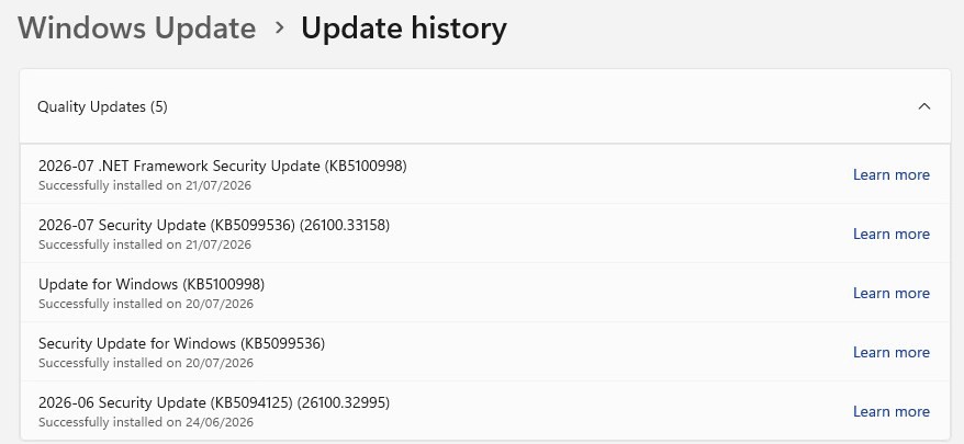

After deploying KB5100998, Windows Update indicated that a reboot was required. Once the system was restarted:
  • Windows Update shows KB5100998 as successfully installed.

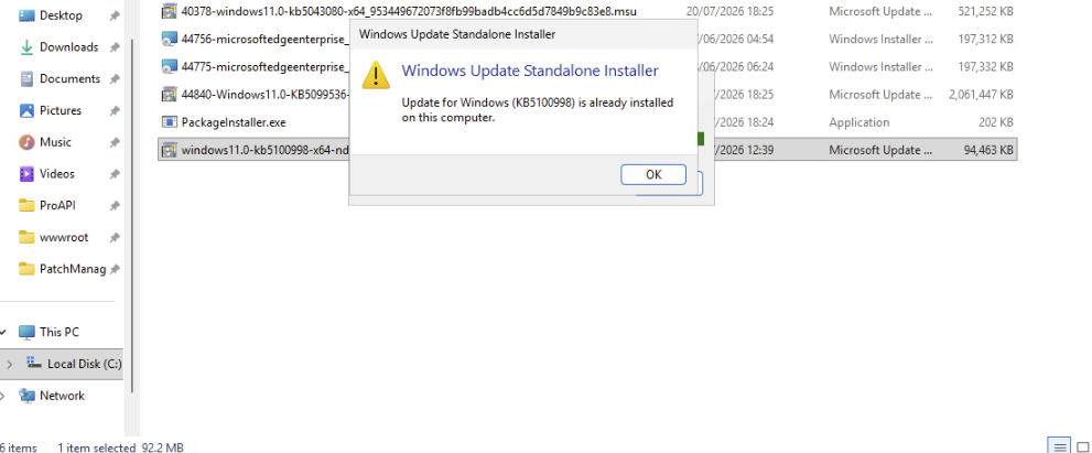

  • Windows Update reports the update as Installed.
  • Manual installation of KB5100998 reports that the update is already installed.
  • The CBS package registry still indicates Install Pending (CurrentState = 60).

During our testing, we observed that if we remove the affected CBS package using DISM and then deploy KB5100998 again, the installation completes successfully and the CurrentState value for the package transitions from 60 (Install Pending) to the expected installed state (70).
