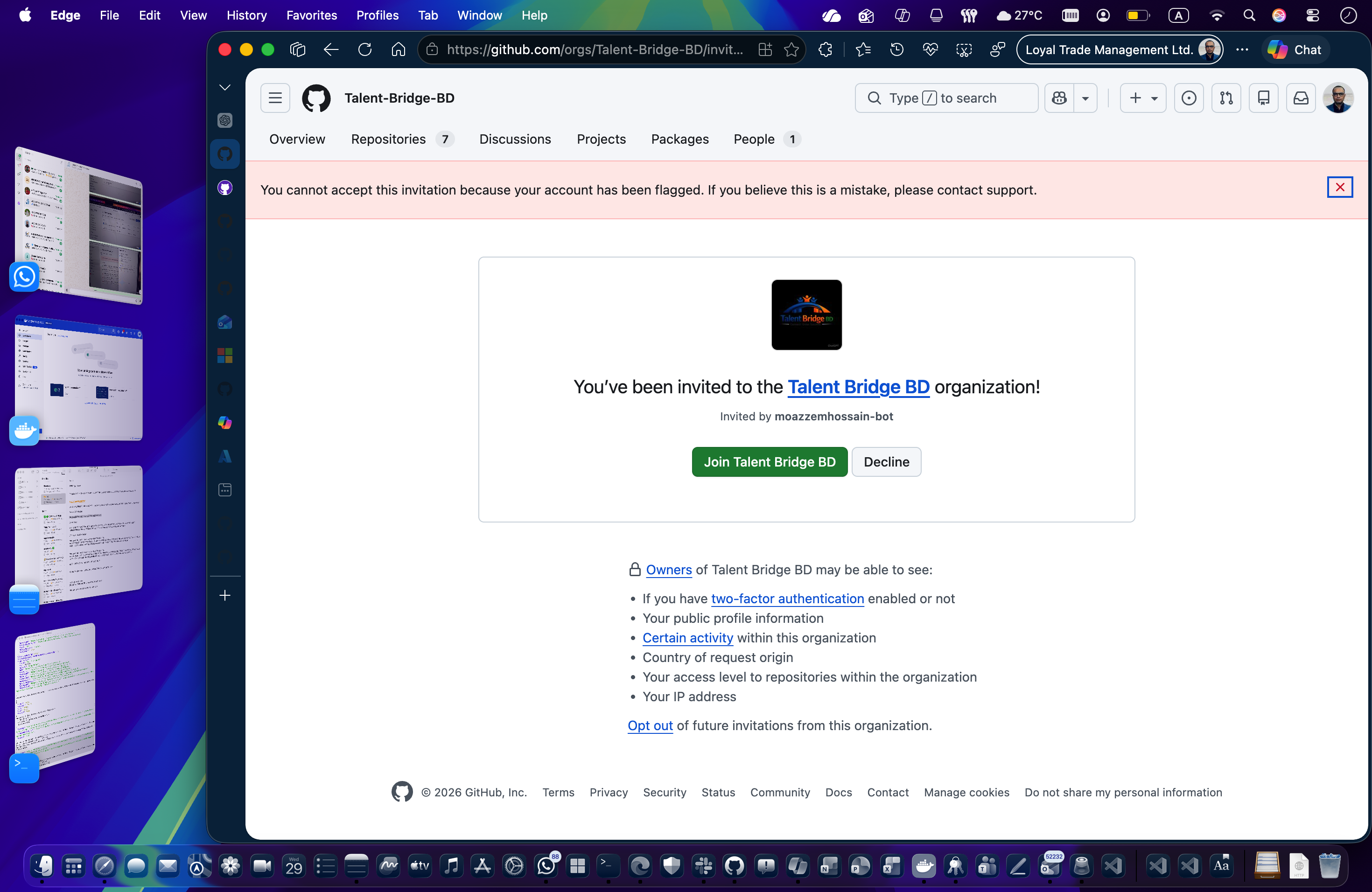

An additional detail that may be relevant is that the GitHub account being used (MoazzemHossain-bot) was previously flagged/restricted by GitHub and I am unsure whether that status could still be affecting GitHub Actions execution. The account can push code, administer the repository, and run GitHub-managed workflows such as CodeQL, but custom workflows never execute.
Has anyone encountered a situation where GitHub-managed workflows run successfully, but all custom workflows remain at 0 runs and manual dispatch returns HTTP 422? Could this be related to an account restriction, workflow approval requirement, or another GitHub Actions limitation?

    I understand that your Azure Static Web Apps deployment workflow never runs and GitHub reports "Actions has been disabled for this user".
    The deployment is failing before Azure Static Web Apps can build or deploy the app. The GitHub-side error: HTTP 422: Actions has been disabled for this user means that GitHub is blocking workflow execution for the user/account/repository context. - https://learn.microsoft.com/en-us/azure/static-web-apps/publish-devops, https://learn.microsoft.com/en-us/azure/static-web-apps/build-configuration.
    The best method to resolve is to:
    • Stop changing Azure Static Web Apps build settings until GitHub Actions can create a run.
    • Verify GitHub Actions is enabled at repository and organization level.
    • If the account-level error remains, escalate to GitHub Support for account restriction review.
    • For immediate deployment, move the repository to an unrestricted GitHub account/org or use Azure DevOps.
    • Reset the Azure Static Web Apps deployment token and update the repository secret.
    • Use a clean Static Web Apps workflow with push, pull_request, and workflow_dispatch.
    After moving the deployment to an unrestricted GitHub account or Azure DevOps and updating the Static Web Apps deployment token, the workflow should create a run. Only after a workflow run starts should you troubleshoot app_location, api_location, output_location, build commands, Oryx, or deployment-token errors.

    The most likely cause is that the GitHub account or organization has a restriction preventing custom GitHub Actions from running. Azure Static Web Apps relies on GitHub Actions, so deployments will never start until Actions can execute.
    But try below:
    • Verify the account's current status with GitHub Support and confirm any previous restrictions have been fully removed.
    • Test with a different unrestricted GitHub user that has admin access to the repository.
    • Check the repository and organization Actions settings for any user-specific restrictions or pending workflow approvals.
    • Confirm the Azure Static Web Apps workflow contains valid on: push and/or workflow_dispatch triggers.
    • Once GitHub Actions can run normally, reconnect the Static Web App to recreate the webhook and deployment workflow.
