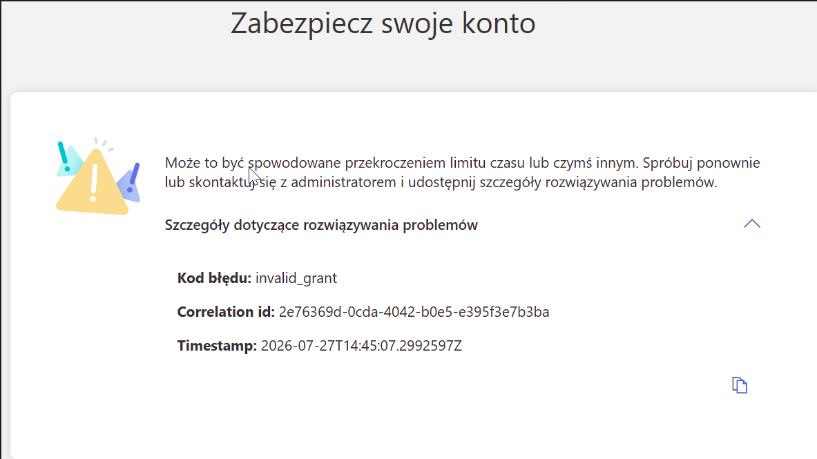

Our goal is to allow users to access the My** **Sign-Ins portal and register authentication methods before enabling SSPR.
I configured Conditional Access according to the Office 365 IT Pros article regarding access to the registration portals. The configuration works perfectly until I add the user to the SSPR-enabled security group.
Once the user is added to the SSPR group, access to the portal fails with an invalid_grant error (screenshot attached).User's image
If I remove the user from the SSPR group, the portal becomes accessible again. The user is not prompted to register methods, which is acceptable for now, but we plan to roll out SSPR in the near future.
