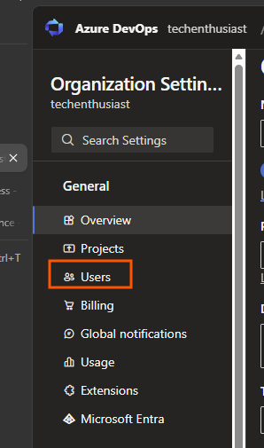

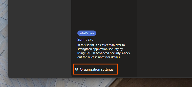

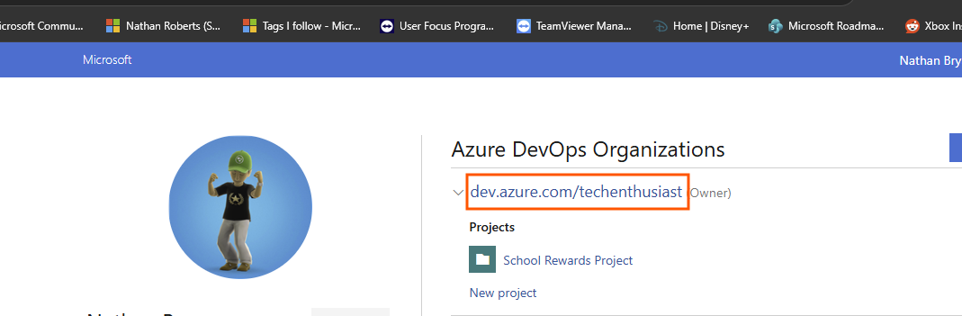

    It could be that you are down as a stakeholder. If you have stakeholder access, you will not see the Repos link. To check, please can you sign into your users page in your organisation. To get there, please sign into your account here: https://aex.dev.azure.com/me
    Once you have signed into your account, please click onto your organisation name
    Then click onto "Organisation settings" at the bottom-left of the screen
    This will take you to your org settings. On the left-hand side menu, please click onto "Users"

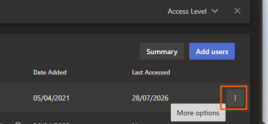

    Then check your access level. Please note that if you were a Visual Studios subscriber, which has expired or being cancelled, you will automatically be converted to a stakeholder. This is what I have recently found out after I was checking for myself. If this is the case, please hover over your account and click onto the more options icon on the right-hand side to change this.
    This will provide you an option to change access.
