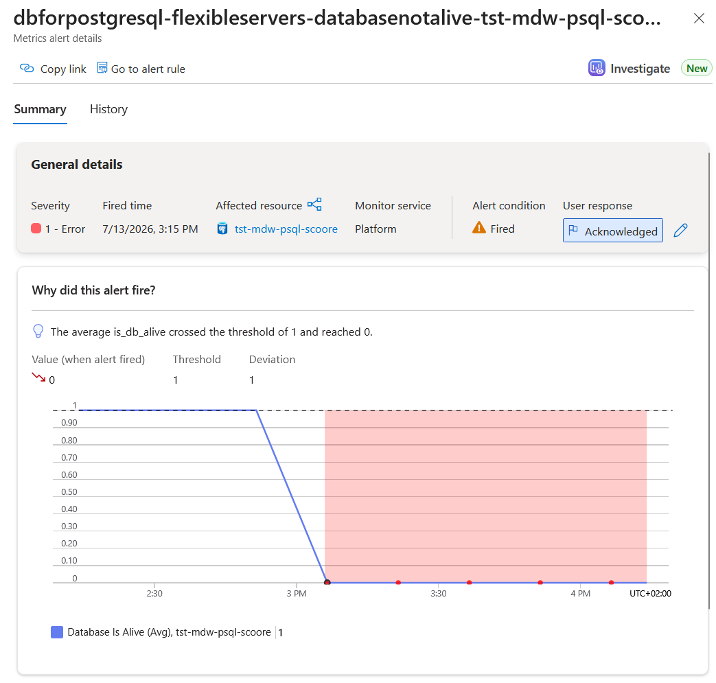

I'm having trouble understanding why my alert is not resolving, even though the metric appears to be back within the expected range.
The alert is configured to fire when the metric is_db_alive is less than 1. My understanding is that once the metric returns to 1, the alert should automatically resolve when autoMitigate is enabled. However, that doesn't seem to be happening.

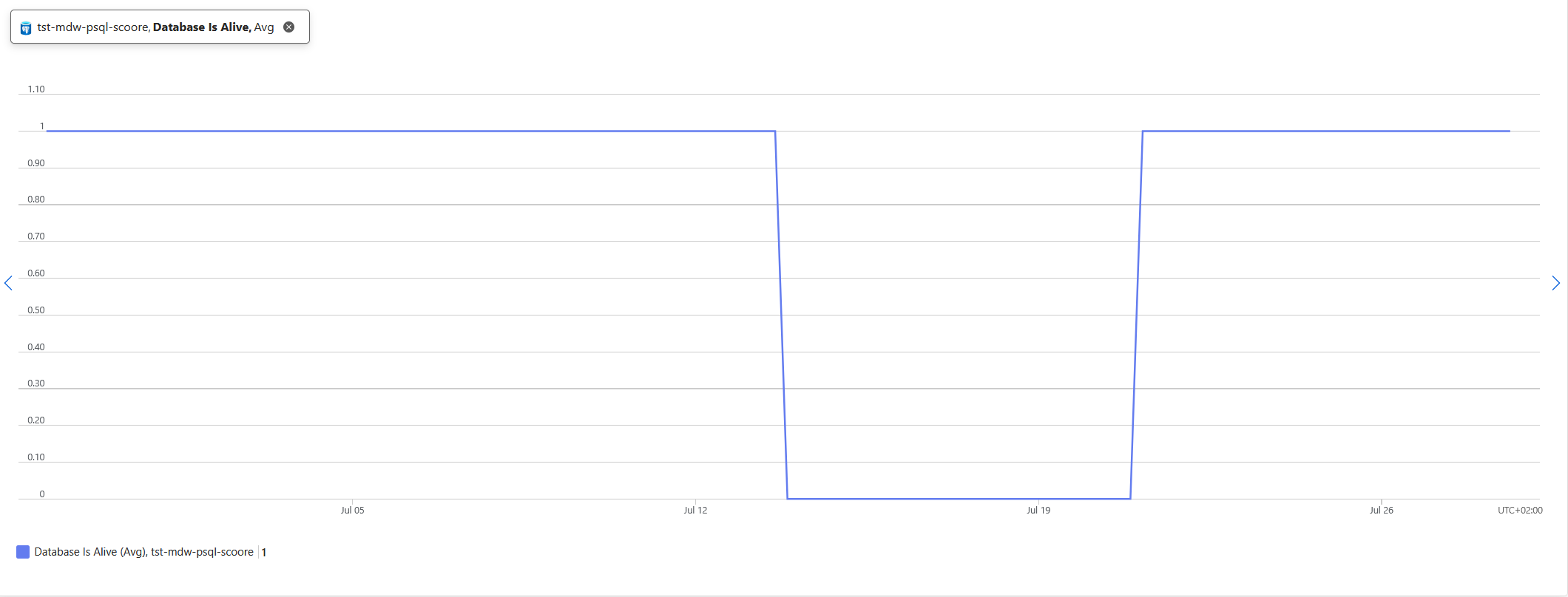

Screenshot 2026-07-28 175906Screenshot 2026-07-28 180257 Am I missing something in how alert resolution works, or is there another factor I should be looking into?

    Your expectation is generally correct: when a metric alert is configured with Auto-mitigate enabled, Azure Monitor will automatically resolve the alert after the alert condition is no longer met during subsequent evaluations.
    From the screenshots, the alert fired when is_db_alive dropped from 1 to 0, which matches the configured condition (Less than 1). The metric chart also shows that the value later returned to 1, indicating that the database became available again.

    Also, the Acknowledged status shown in the alert does not affect auto-resolution. It only reflects the user response state and does not prevent the alert from transitioning to Resolved.

    A value of 1 should clear this stateful metric alert, but Azure Monitor resolves it only after the condition is false for three consecutive evaluations on the monitored time series. The Acknowledged value in your screenshot is only the user-response state; it does not change the Fired or Resolved condition.
    Open the alert rule and confirm Automatically resolve alerts is enabled, corresponding to autoMitigate being true. Reproduce the evaluation in Metrics using the same resource, metric namespace, dimensions, Average aggregation, period, and evaluation frequency. Verify that is_db_alive emitted 1—not missing data—for all three evaluation windows, and check Alert history for rule edits or state changes.
