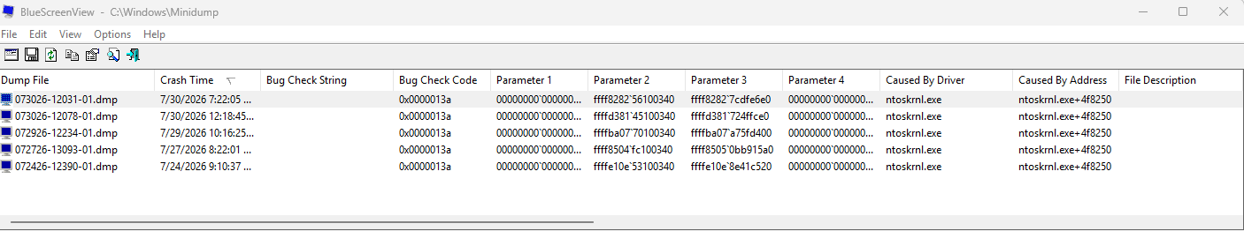

Can someone please help me trace what caused of my KERNEL HEAP MODE CORRUPTION. It's getting worse 3x a day. please
kids youtube 20 Reputation points
2026-07-29T23:45:05.1666667+00:00
ExtensionGallery settings after reading 'SOFTWARE\Microsoft\Debug Engine' registry:
ExtensionGallery ExtensionRepository: Implicit
************* Path validation summary **************
Response                         Time (ms)     Location
Deferred                                       srv*
************* Preparing the environment for Debugger Extensions Gallery repositories **************
   ExtensionRepository : Implicit
   UseExperimentalFeatureForNugetShare : true
   AllowNugetExeUpdate : true
   NonInteractiveNuget : true
   AllowNugetMSCredentialProviderInstall : true
   AllowParallelInitializationOfLocalRepositories : true
   -- Configuring repositories
      ----> Repository : LocalInstalled, Enabled: true
      ----> Repository : UserExtensions, Enabled: true
>>>>>>>>>>>>> Preparing the environment for Debugger Extensions Gallery repositories completed, duration 0.000 seconds
************* Waiting for Debugger Extensions Gallery to Initialize **************
>>>>>>>>>>>>> Waiting for Debugger Extensions Gallery to Initialize completed, duration 0.016 seconds
   ----> Repository : UserExtensions, Enabled: true, Packages count: 0
   ----> Repository : LocalInstalled, Enabled: true, Packages count: 46
Microsoft (R) Windows Debugger Version 10.0.29617.1000 AMD64
Copyright (c) Microsoft Corporation. All rights reserved.
Loading Dump File [C:\Windows\Minidump\073026-12031-01.dmp]
Mini Kernel Dump File: Only registers and stack trace are available
Deferred                                       srv*
Symbol search path is: srv*
Executable search path is:
Windows 10 Kernel Version 26100 MP (12 procs) Free x64
Product: WinNt, suite: TerminalServer SingleUserTS
Kernel base = 0xfffff805`97c00000 PsLoadedModuleList = 0xfffff805`98af51d0
Debug session time: Thu Jul 30 07:22:05.841 2026 (UTC + 8:00)
System Uptime: 0 days 7:02:56.620
Loading Kernel Symbols
Press ctrl-c (cdb, kd, ntsd) or ctrl-break (windbg) to abort symbol loads that take too long.
Run !sym noisy before .reload to track down problems loading symbols.
Loading User Symbols
Loading unloaded module list
For analysis of this file, run !analyze -v
nt!KeBugCheckEx:
fffff805`980f8250 48894c2408      mov     qword ptr [rsp+8],rcx ss:0018:ffffdc88`3c53f450=000000000000013a
6: kd> !analyze -v
*                        Bugcheck Analysis                                    *
KERNEL_MODE_HEAP_CORRUPTION (13a)
The kernel mode heap manager has detected corruption in a heap.
Arguments:
Arg1: 0000000000000017, The heap detected that a block was corrupted in a delay free list. This is likely a use-after-free error or a buffer overflow of an adjacent block.
Arg2: ffff828256100340, Address of the heap that reported the corruption
Arg3: ffff82827cdfe6e0, Address at which the corruption was detected
Arg4: 0000000000000000

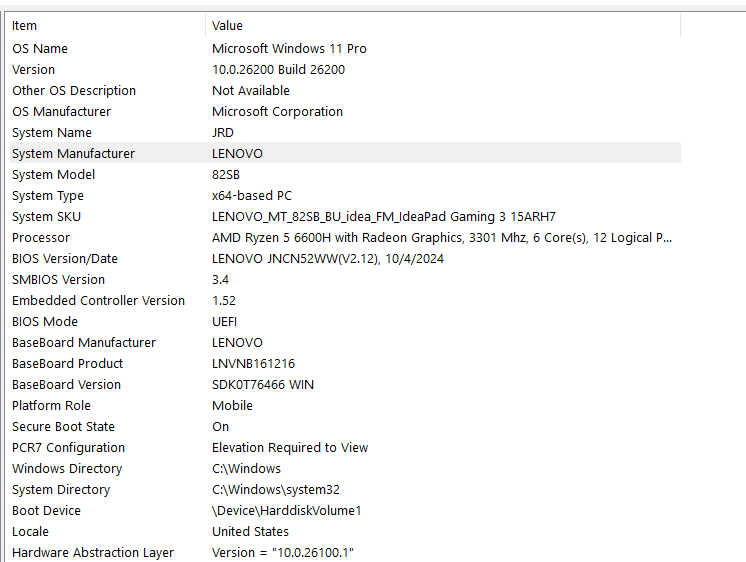

Ivan B 120.2K Reputation points Independent Advisor
2026-07-30T00:18:35.3+00:00
Hi ,
Search for msinfo32.exe in the search bar, take a screenshot, and post it here so we can see the correct laptop model or desktop configuration.
Access the c:\windows\minidump folder, copy the files to your desktop, then upload them to OneDrive or Google Drive and post the link here for analysis.
Thanks
