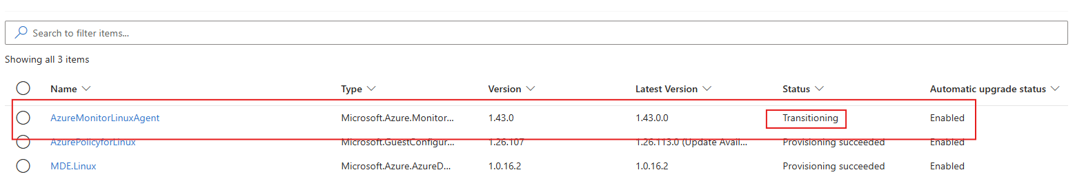

AMA agent got stuck on transitioning state.
Sandip Khadka 40 Reputation points
2026-07-31T04:44:29.9533333+00:00

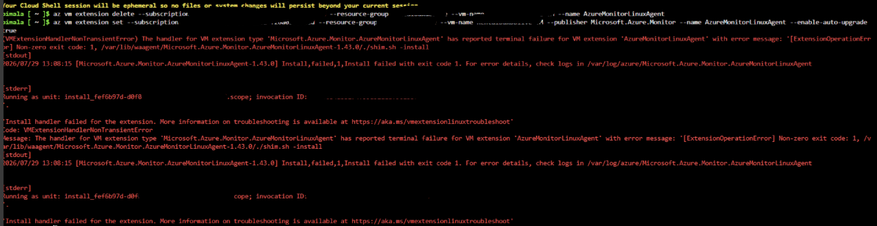

One of my vm get stuck in this transitioning state and I have also tried to delete and reinstalled it but it did not work and also i did it from the azure cli also but it shows error.
I have also checked the microsoft documentation for this but there are not any solutions regarding this.

    Hi @Sandip Khadka The Azure Monitor Agent (AMA) stuck in a Transitioning state, which can prevent subsequent uninstall or reinstall operations from completing successfully. This typically indicates that the extension provisioning process has not reached a terminal state and Azure is still tracking an in-progress extension operation.
    To further troubleshoot please check the following:
    Verify the current extension status
    • Navigate to VM > Extensions + Applications in the Azure portal.
    • Confirm whether AzureMonitorWindowsAgent or AzureMonitorLinuxAgent has moved to Provisioning succeeded and is no longer showing Transitioning, Creating, or Deleting.
    Collect AMA extension logs
    Review the latest log files for provisioning failures, authentication issues, IMDS connectivity problems, or repeated retry attempts.
    Run the AMA Troubleshooter (Windows)
    • Microsoft provides a built-in AMA Troubleshooter that can help identify common deployment and configuration issues.
    • Please share the generated report if any failures are detected.
    Validate Data Collection Rule (DCR) associations
    • If the VM remains associated with a DCR, AMA may be automatically redeployed after removal.
    • Verify whether the VM is still listed under any DCR resources and remove the association if the goal is to permanently uninstall AMA.
    • Microsoft has documented scenarios where DCR associations cause AMA to be re-created after deletion.
    Verify Managed Identity and IMDS connectivity
    • AMA relies on managed identity and access to the Instance Metadata Service (IMDS) for configuration retrieval.
    • Any connectivity or authentication issues can cause the extension to remain in a non-terminal provisioning state.
    Confirm no extension operation is still pending
    • If Azure still reports an extension operation in progress, wait for it to complete before attempting another uninstall or install operation.
    • Extension operation serialization can prevent additional actions while a previous operation is still active.
