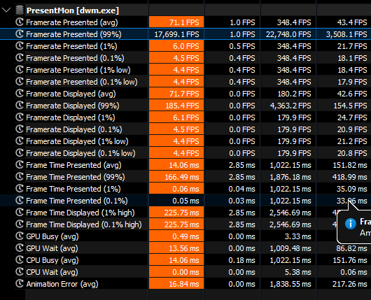

have stuttering/hitching issues with my fairly higher end PC and its driving me crazy!
vano 0 Reputation points
2026-08-02T00:57:14.2833333+00:00
Screenshot 2026-08-02 034948
I recently noticed that dwm.exe has framerate presented in crazy numbers, dont know if it means anything but feels like it does. and I have bad stutters on my pc.

    Based on everything you've tested, you've already ruled out most of the common hardware causes. Since the issue remained even after replacing major components, reinstalling Windows, testing different drivers, and updating the BIOS, the behavior may be related to how Windows, display composition (DWM), drivers, or background processes are interacting on your specific configuration rather than a single failing component.
    At this stage, a few focused checks may help gather more useful data:
    1. Perform a Clean Boot and test whether the stuttering persists with only Microsoft services running.
    2. Capture a trace using Windows Performance Recorder (WPR) during a stutter event and review it with Windows Performance Analyzer (WPA) to identify whether DWM, storage, interrupts, or another process is causing frametime spikes.
    3. Temporarily disable any overlays or monitoring tools (such as RTSS, MSI Afterburner, Discord overlays, RGB utilities, or browser hardware acceleration) and retest.
    The unusually high frame rate values reported for dwm.exe are not necessarily an indication of a problem by themselves, as some monitoring tools can report DWM metrics differently. Since you've already eliminated many hardware variables, collecting a performance trace will likely provide more insight than continuing to replace components.
