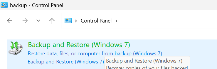

    If you need to create a full image of your OS + Files + Whole Drive, I suggest the good old backup tool:
    User's image as Recovery Drive can help only with booting issues. Additionally, you can create one by downloading
    Windows ISO from Microsoft and boot from it, then create Recovery Drive from the installation media
