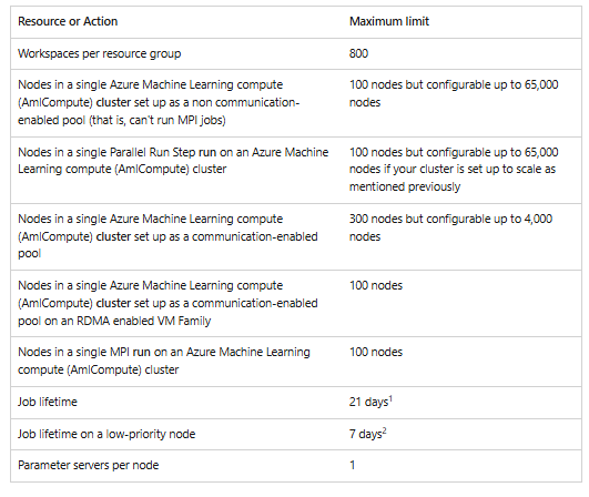

    There's a published limit that settles this: Azure ML enforces a maximum job lifetime of 21 days (7 days for jobs on low-priority nodes), and the documentation notes that "data for jobs not completed within the maximum lifetime isn't accessible." Your jobs are showing Running at 60+ days roughly three times past that ceiling. Whatever they were doing, the service itself no longer considers them live work.
    That's consistent with everything else you're seeing: the cancel path evaluates the job as already terminal and refuses; the delete path reads the last-written status of Running and refuses. Two checks, two different answers, and no actual compute behind either. Your read that this is a display/metadata nuisance rather than a running workload is correct.
    https://learn.microsoft.com/en-us/azure/machine-learning/how-to-manage-quotas?view=azureml-api-2

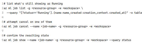

    Worth trying first:- CLI rather than the studio
    The CLI occasionally succeeds where the portal refuses, so it's a cheap thing to rule out:
    Please try this on one job first and send me the exact error text and any correlation/request ID it returns — that detail materially speeds up the backend investigation.

    • Archiving won't help here. az ml job archive operates on jobs in a terminal state, so it will most likely return the same conflict. Worth thirty seconds to confirm, not worth working around.
