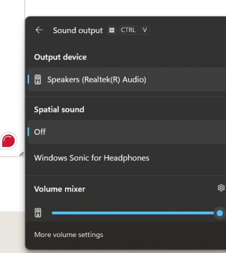

THE SOUND ON MY CHROME LAPTOP CAN'T BE HEARD WHEN I ATTACH MY HDMI CORD FROM MY COMPUTER TO MY TELEVISION.

    You say it is a Chrome Laptop.
    Is it a Chromium Laptop or a Windows 11?
    If it is Windows 11, you need to change the sound routing to HDMI using the Windows + CTRL + V buttons.
    I look forward to hearing from you to get the results of the troubleshooting.
