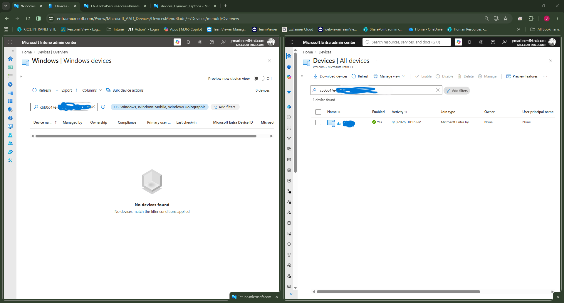

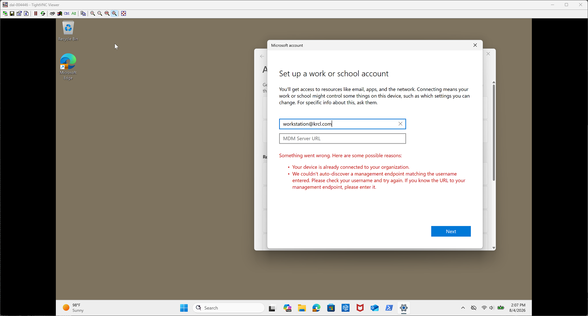

We have several devices that are able to enroll into Intune. No user is able to enroll. Not an admin. Not a DEM. No one. I have dsregcmd /leave multiple times and same result.
What I have been able to determine is that the Enterprise Management scheduled tasks and services are not found on the devices. This started a little over two weeks ago. We were able to get one device enrolled, but thru much nashing of teeth and timeing (hours of un/re-enrolling). Two other devices in this same timeline were pushed into Intune via MDE. One was device enrolled instead of user enrolled.
What would be the next step in resolving this? BTW, all the steps in the AI answer have already been done.
