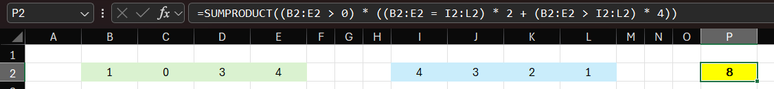

  2. IlirU 2,571 Reputation points Volunteer Moderator
    2026-08-08T09:19:03.1566667+00:00
    Try this formula:
    =SUMPRODUCT((B2:E2 > 0) * ((B2:E2 = I2:L2) * 2 + (B2:E2 > I2:L2) * 4))
    If you are using Excel 2021 or newer versions, then instead of the SUMPRODUCT function in the formula, you can simply use the SUM function. So replace the SUMPRODUCT function in the formula with the SUM function.
    Regarding the second problem, you should use the formula already suggested by AI answer, which is this:
    =SUMIFS($E18:$L18, $A18:$H18, "COFIELD")-600
    If you want the result to come out with a plus or minus sign, then you will need to use custom formatting. For such a thing, you will need to select the cell where you want to get the expected result. Then open the Format Cells window (you can use the Ctrl + 1 buttons). Select Custom and in the Type field set this: +0;-0;0 and finally click the OK button.
    This will cause:
    • Values ​​above 600 to be displayed with + (e.g. +30).
    • Values ​​below 600 to be displayed with - (e.g. -10).
    • If the value is exactly 600, 0 will be displayed.
    Hope this helps.
