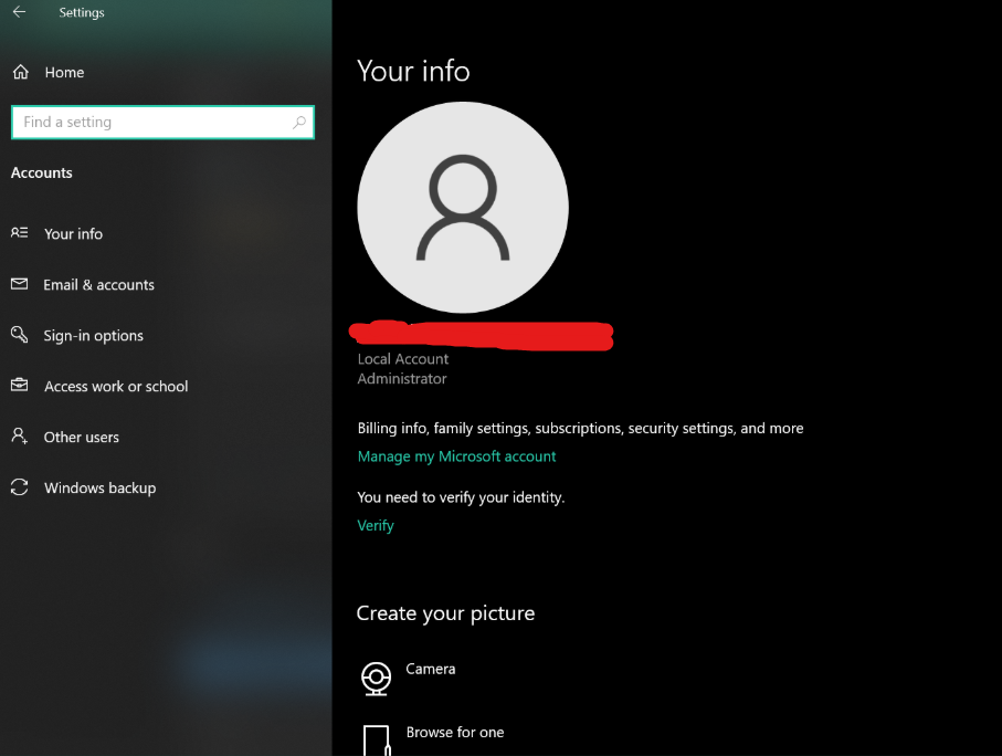

I am logged in via a local account(supposedly) on a Windows 10 PC.
However, as you can see, there is no “Sign in with a Microsoft account instead” option, which is the main issue right now. My Windows account settings are not functioning properly, and I do not know why.

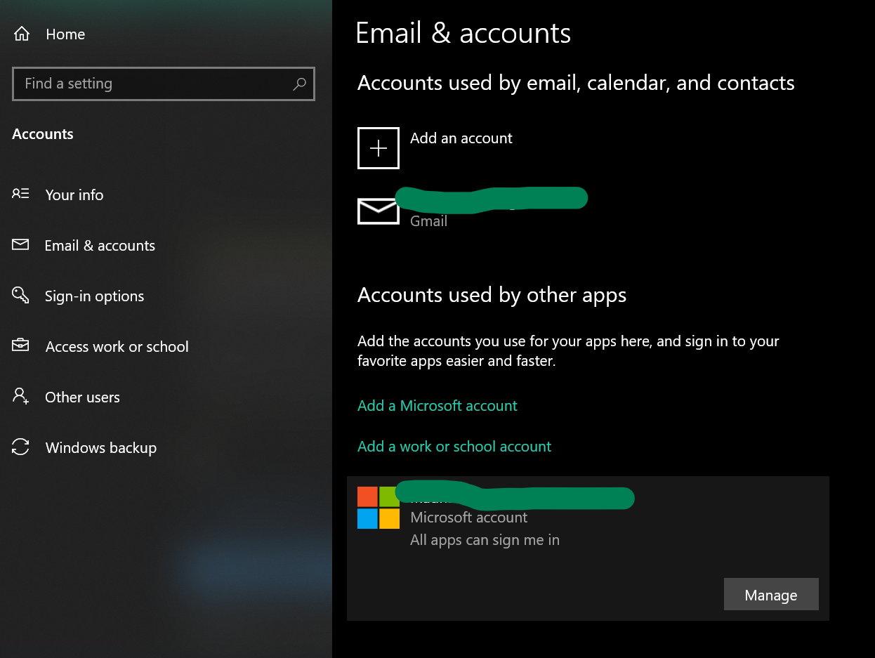

This is the second part of the issue: although I am supposedly using a local account, the Microsoft account that was locked for some reason—and that I am trying to remove—still appears as a signed-in Microsoft account. There is also no option to change “All apps can sign me in,” and when I click it, nothing else appears.

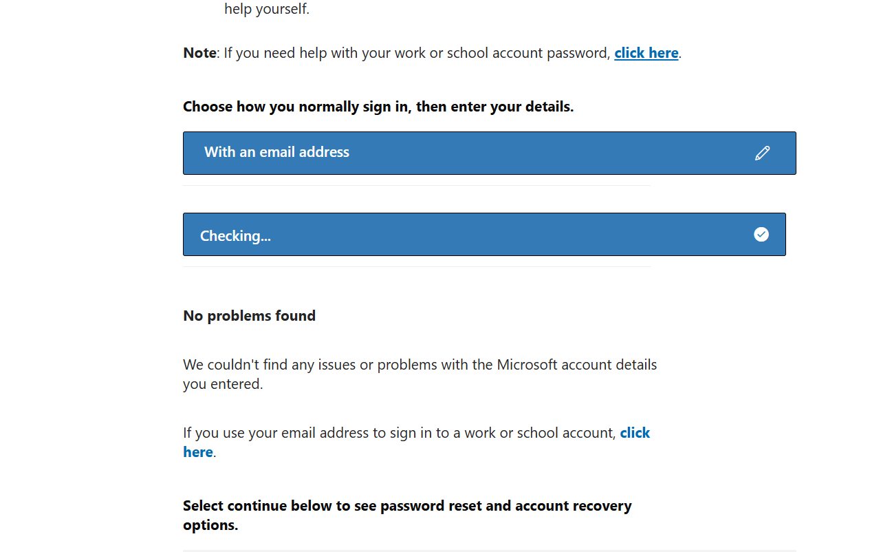

If I click “Manage,” it takes me to the sign-in portal, which is locked. I cannot seem to remove or delete this account no matter what I try.

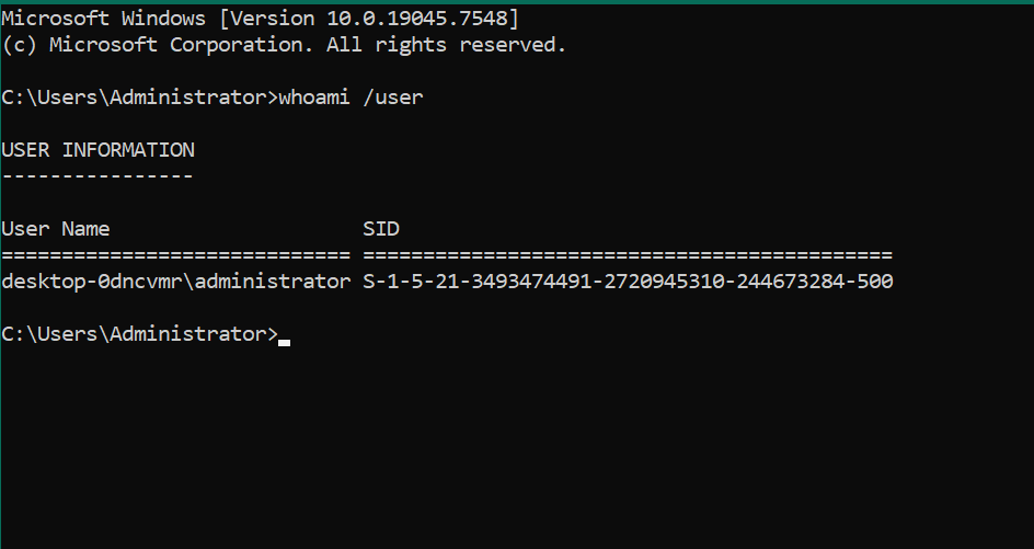

    A normal account can have administrator privileges, while the built-in Administrator is a separate Windows account identified by a SID ending in -500. Please run: whoami /userOnly a SID ending in -500 confirms that the current account is the built-in Administrator.
    You said that Windows treats this account differently; how exactly? How does that affect the usage of Microsoft accounts?
    The built-in Administrator is intended primarily for system administration and recovery. It runs with elevated behaviors; Windows Setup normally disables it and creates a separate local account that belongs to the Administrators group.
    That is why I wanted to identify the account type before interpreting the missing Microsoft-account option. If the SID does not end in -500, this distinction does not explain the problem.
    “The locked account under Email & accounts can be stored only for Microsoft apps, so it does not necessarily mean you use that account to sign in to Windows.”
    Windows maintains two separate relationships:
    • Settings > Accounts > Your info identifies the account used to sign-in to the Windows profile.
    • Settings > Accounts > Email & accounts can contain additional accounts used by Microsoft Store, Mail, OneNote, and other applications.
    Therefore, Windows can display Local Account under Your info while retaining a Microsoft account under Email & accounts for application sign-in. The presence of the locked account there did not necessarily mean that it was being used to sign in to Windows.

    First, please check whether the current profile is the built-in Administrator account:
    1. Open Command Prompt.
    2. Run: whoami /user
    If the SID ends in-500, this is the built-in Administrator account. Windows treats that account differently, so create a normal local administrator account under Settings > Accounts > Family & other users, sign in to it, and then try Settings > Accounts > Your info > Sign in with a Microsoft account instead.
