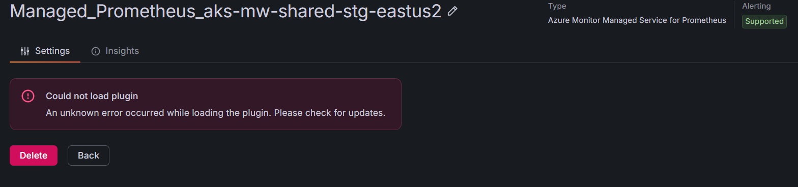

What are the current versions of Grafana and the Prometheus** **plugin after the upgrade?- Are you receiving any specific error** messages, warnings, or error **codes when the plugin fails to load? If so, please share the exact error message and a screenshot if available.
- Error message: *"Managed_Prometheus_aks-mw-shared-dev-southcentralus plugin failed. Error: Could not load plugin"

Thank you for sharing the details. After reviewing the behavior, the "Could not load plugin" error appears to be occurring before Grafana even reaches the authentication or query stage. This is important because it suggests we're dealing with a plugin loading issue rather than a permissions, authentication, or connectivity problem.

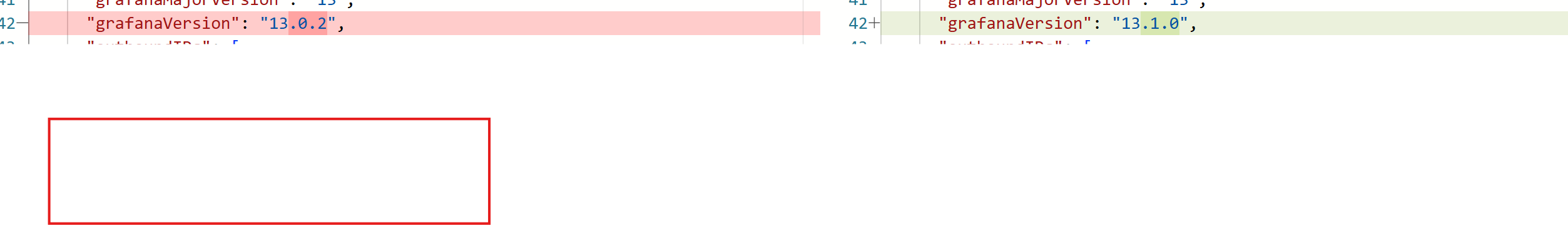

What makes this particularly interesting is that the issue started immediately after the automatic upgrade from Grafana 13.0.2 to 13.1.0 on August 5th and is reproducible for all users, even in private browsing sessions. Based on that behavior, this appears less likely to be related to your tenant configuration and more likely related to how the plugin is being delivered or loaded after the upgrade.
