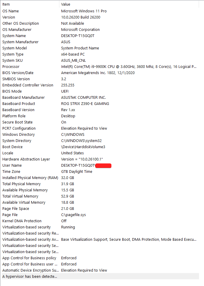

  1. Ivan B 125K Reputation points Independent Advisor
    2026-08-09T21:55:08.1066667+00:00
    Hi ,
    Search for msinfo32.exe in the search bar, take a screenshot, and post it here so we can see the correct laptop model or desktop configuration.
    Access the c:\windows\minidump folder, copy the files to your desktop, then upload them to OneDrive or Google Drive and post the link here for analysis.
    Thanks
