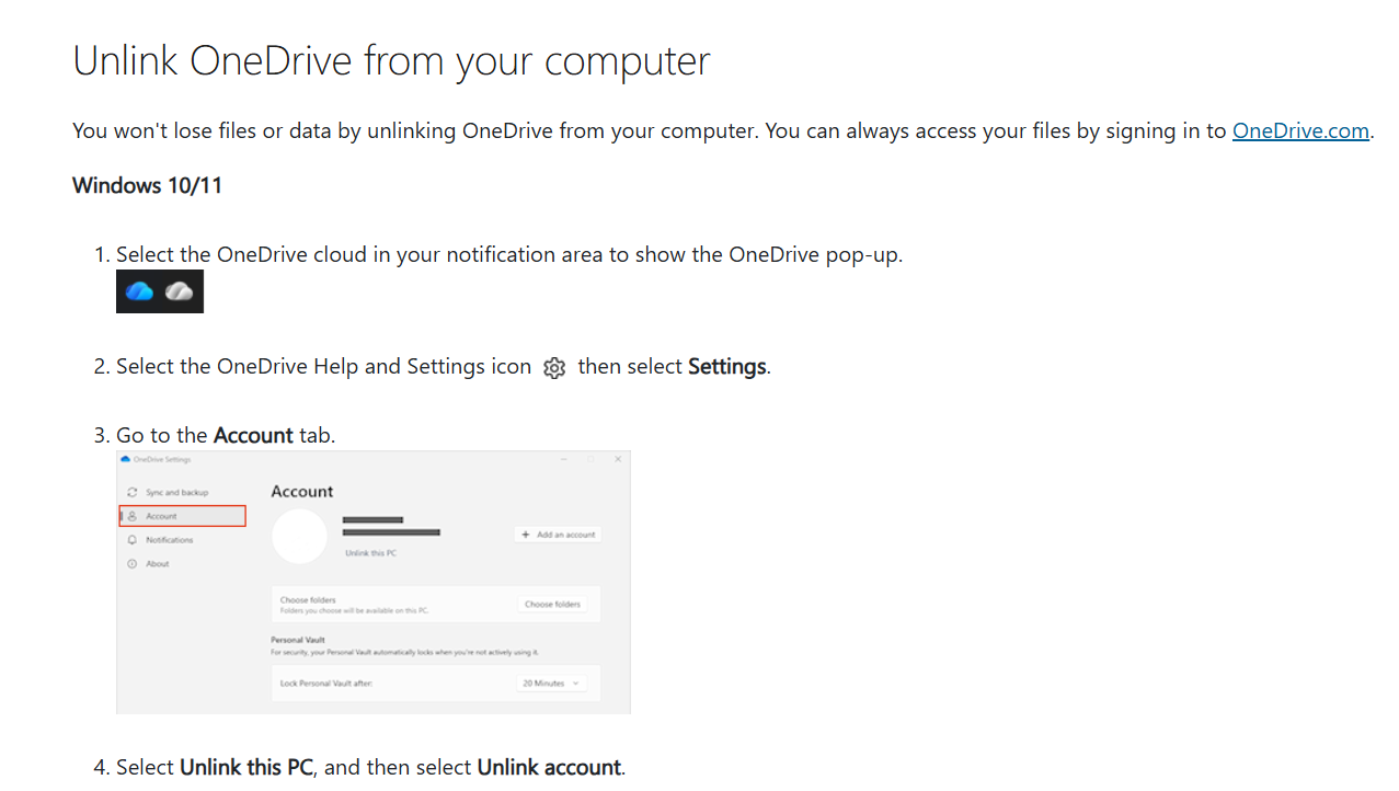

    If you never want to save to OneDrive, see the "Unlink OneDrive from your computer" section in the article at https://support.microsoft.com/en-us/onedrive/turn-off-disable-or-uninstall-onedrive . The screen shot below displays the instructions for Windows from the article. (You will find the corresponding instructions for MacOS in that same article.)
