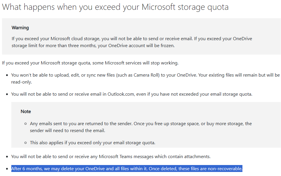

    You said you last used it in 2024 and recently renewed. Does that mean between 2024 and renewal time, you were not on any subscription? If so, if you used more than 5 GB of OneDrive storage during this gap time, your data is permanently deleted at this point.
    See Microsoft's explanation here: https://support.microsoft.com/en-us/onedrive/microsoft-storage-quotas
    So, it is important to understand how long the gap had been since the plan expired and your recent renewal.
