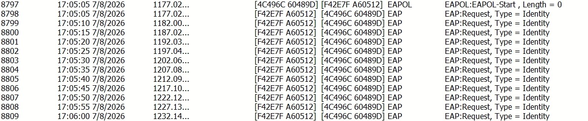

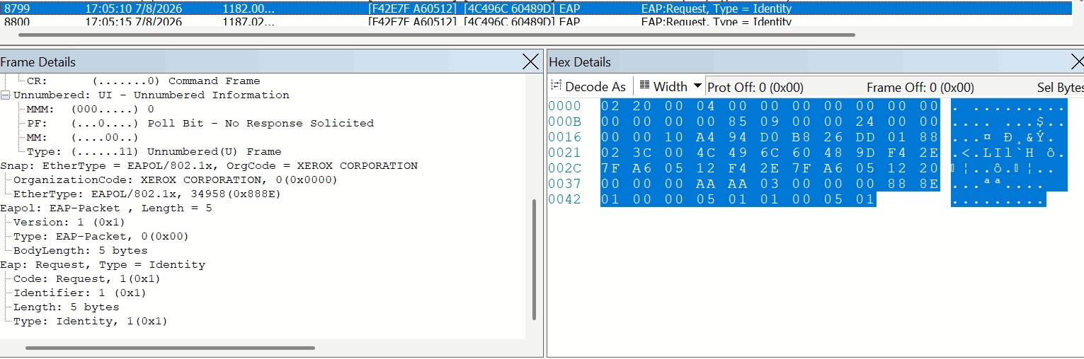

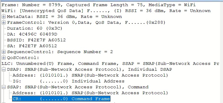

Hello everyone.
I'm integrating Aruba access points managed by Aruba Central with my internal NPS server for wireless client authentication using the EAP-PEAP method. The problem doesn't appear to be on the NPS side, as I replicated the client architecture in a lab environment: I deployed a domain controller (AD) on a Windows server, an NPS on another Windows server, and connected a standalone Aruba access point.
In this scenario, clients authenticate and connect to the Wi-Fi without issue.
However, the same isn't happening in the client environment. The user is prompted to enter their Active Directory credentials, but after entering them, the authentication window reappears repeatedly, without completing the connection process. Has anyone experienced similar behavior or have any suggestions as to where the problem might lie?

    For PEAP with NPS, the repeated credential prompt usually means the 802.1X exchange is not completing, and the first checks should be the client EAP method, certificate trust, and NPS/AP policy alignment.
    Based on the symptoms and the packet view showing repeated EAP-Request/Identity, use this troubleshooting path:
