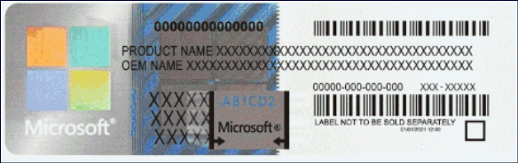

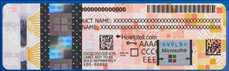

    In this case, the unique key must either be flashed in the BIOS (we have already found out that this is not the case), or be on the COA (certificate of authenticity) glued to the body of the system unit. Carefully inspect the system unit to see if there is anything similar on it.:
    Write about the result.

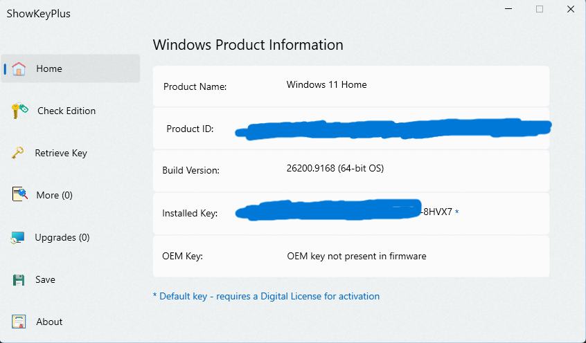

    There is no pre-installed (OEM) OS on this PC (otherwise there would be a key embedded in the BIOS). The "installed key" points to the well-known "stub" YTMG3-N6DKC-DKB77-7M9GH-8HVX7, not the unique key. Please tell us how the license for this OS was obtained (together with the PC or separately from the PC).

    Download the ShowKeyPlus program from the Microsoft Store and run it: https://apps.microsoft.com/detail/9pkvzcprx9nv?hl=en-us
    Take a screenshot of the program's homepage with the information "Windows product information". Just make sure to color in all the characters except the last five in the "Installed key".
