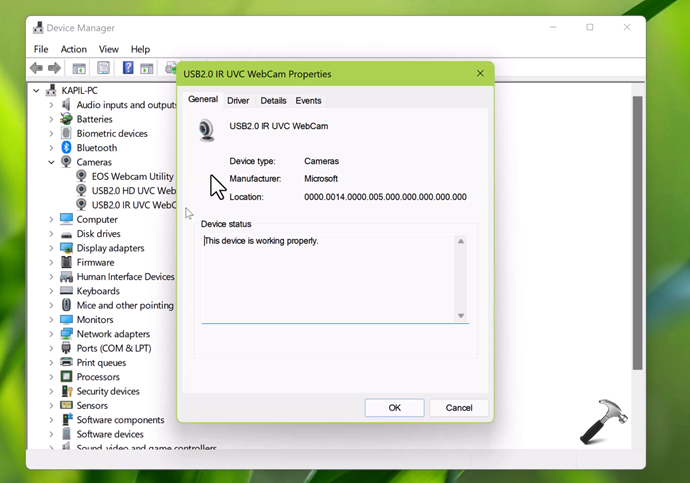

  1. Kapil Arya 38,281 Reputation points Volunteer Moderator
    2026-09-03T11:05:57.4333333+00:00
    Make sure you've IR based webcam installed correctly and working fine.
    Check IR based webcam
    Try setting Group Policy "Allow users to log on using biometrics" at Computer Configuration > Administrative Templates > Windows Components > Biometrics to Enabled.
    Hope this helps!

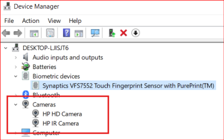

  2. GsN5034 - IA 76,205 Reputation points Independent Advisor
    2026-09-03T04:05:45.34+00:00
    Hello,
    For Windows Hello facial recognition to work properly, the IR sensor and its related driver must be working correctly. A standard webcam alone is not enough for facial recognition. If you previously used Windows Hello facial recognition and it has stopped working, here are a few things you can try:
    1
    Remove your Windows Hello PIN and set it up again.
    Go to Start.
    Select Settings > Accounts > Sign-in options.
    Expand the Windows Hello PIN section, click "Remove",
    Once done, set up Windows Hello PIN again and see if it enables the 'Windows Hello Facial recognition' feature.
    2
    Reinstall the Camera and IR sensor drivers in Device Manager.
    • Open Device Manager.
    • Expand the arrow next to Cameras or Biometrics.
    • Right-click your integrated camera driver first, select Uninstall device, check the 'Attempt to delete the driver software for this device' box, then click Uninstall.
    • Follow the same process for IR Sensor drivers.
    • Once uninstalled, restart your computer and check if the Windows Hello Facial feature is working.
    (Example screenshot showing the integrated webcam driver and IR Camera drivers). If the IR camera drivers are missing, the Windows Hello Facial recognition won't work.
