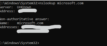

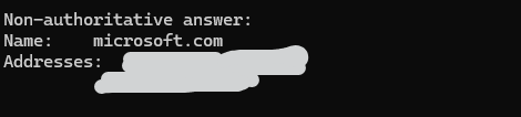

    Also, please open Command Prompt and run the following with the VPN OFF:
    nslookup microsoft.com
    Then repeat the same command with the VPN ON and post both results.
    Those results should help determine whether this is a DNS, routing, proxy, VPN, or ISP-related issue before attempting more invasive repairs.
