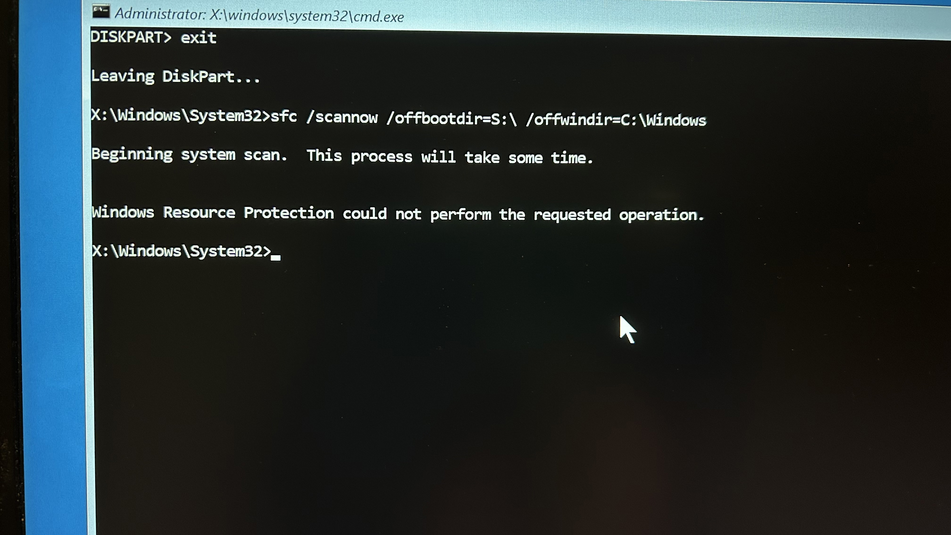

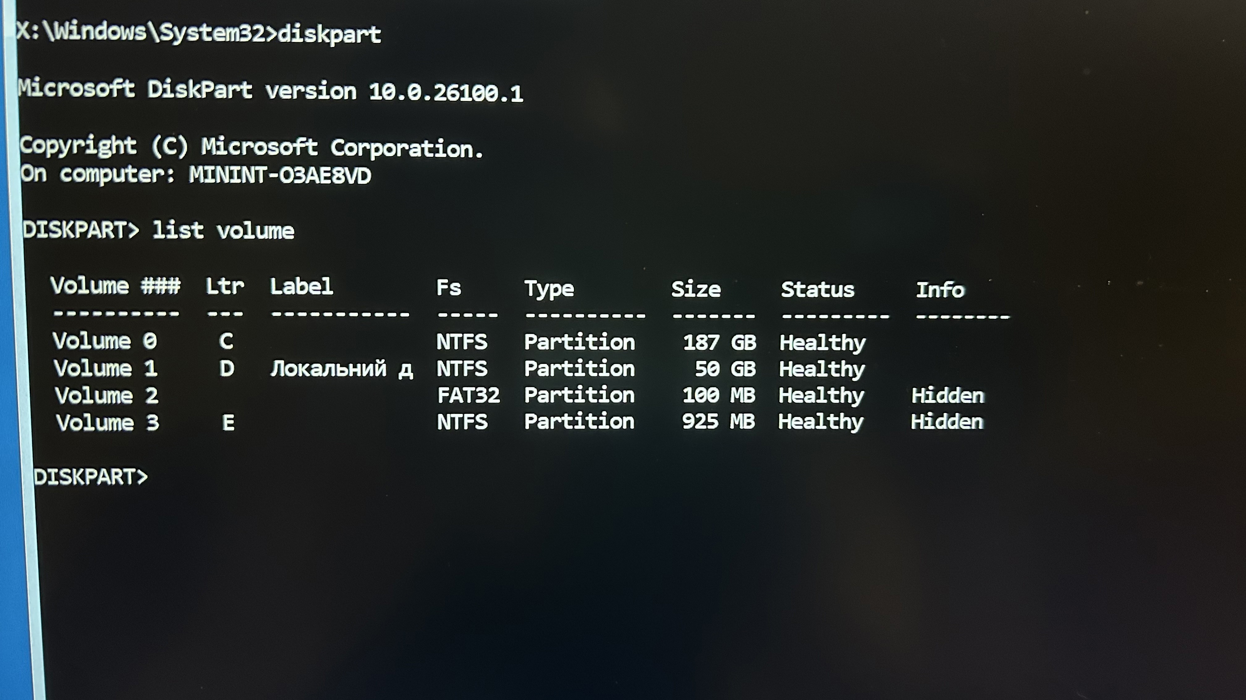

The system stops at the Window Recovery screen with:
”Your PC/Device needs to be repaired”
”An unexpected error has occurred.”
Error code: 0xc0430001
HP laptop, Windows 11, x64
Tried different recovery options from Recovery menu - unsuccessful. I have access to cmd from there, but not sure what I should do.
It would be great not to reset all the data on this device.
Thanks in advance!
