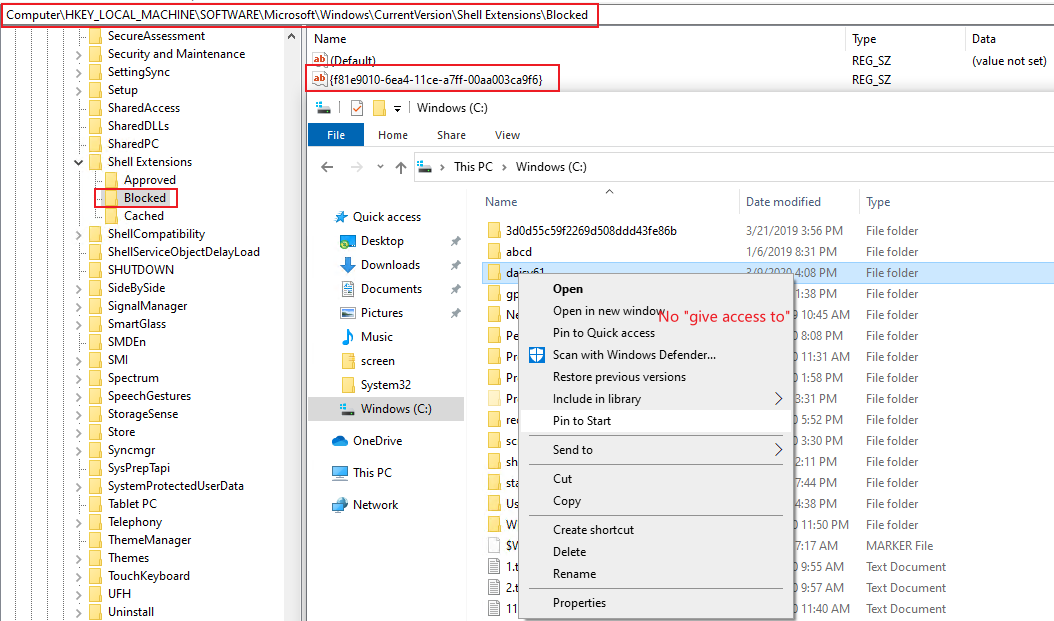

I am trying to remove the option "Give Access to option" from Windows Explorer Context Menu from all devices in our company.
I have found the below procedure to follow and its working when I setup in 1 device.
1.Press Windows Key + R then type regedit and hit Enter to open Registry Editor.
2.Navigate to the following registry key:
HKEY_LOCAL_MACHINE\SOFTWARE\Microsoft\Windows\CurrentVersion\Shell Extensions
3.Right-click on Shell Extension then select New > Key.
4.Name this newly created key as Blocked and hit Enter. If the Blocked key is already present then you can skip this step.
5.Now right-click on Blocked then select New > String Value.
6.Name this string as {f81e9010-6ea4-11ce-a7ff-00aa003ca9f6} and hit Enter.

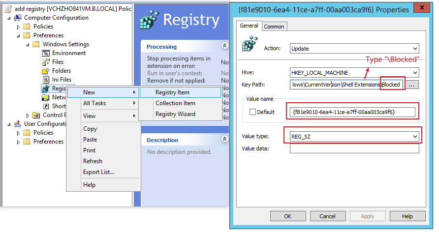

I am trying to create a GPO which will do this for all the device in the company.
I have tried creating a GPO under Computer Configuration->Preferences->Registry->New->Registry Item
After this I am sort of stuck.
I can do the Steps 1-3 but according to the steps 4. I need to create a new key name Blocked.
I don't see any option to create that.
I can do the steps 6.Name this string as {f81e9010-6ea4-11ce-a7ff-00aa003ca9f6} and hit Enter.
Can some one please help.

    Based on the description, I did a test in my lab, and it works fine.
    We can try the steps below:
    1.Create an OU and put all devices we want into this OU.
    2.Create a GPO and link it to the OU above.
    3.Edit the GPO as below: navigate to Computer Configuration->Preferences->Windows Settings->Registry->New ->Registry Item
    Action: Update
    Hive: HKEY_LOCAL_MACHINE
    Key Path: SOFTWARE\Microsoft\Windows\CurrentVersion\Shell Extensions\Blocked (we add "\Blocked")
    Value name
    Default: {f81e9010-6ea4-11ce-a7ff-00aa003ca9f6}
    Value type: REG_SZ
    4.Run gpupdate /force on one device and check if the GPO takes effect.
    Hope the information is helpful. If anything is unclear, please feel free to let us know.
