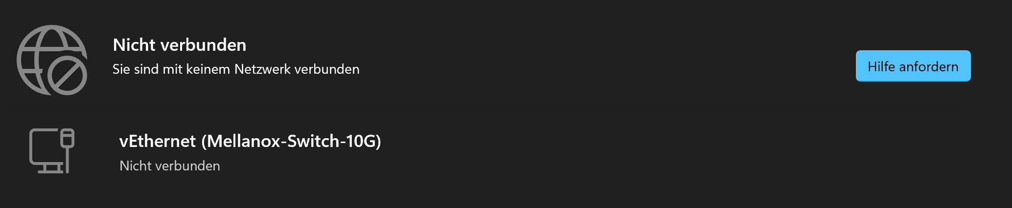

Since I have installed the update KB5129195 on Windows 11 Pro 25H2 with also Hyper-V installed, the NCSI (NlaSvc) service seems to have stopped working. Also the affected network adapter is a Hyper vSwitch.
The last NCSI log entry I have is from 2026-09-25 where I have installed this update and after that no log entry anymore. But I have restarted the machine multiple times, no change.
Another log entry in the NlaSvc logs appears after every reboot with Event-ID 4205 with failure code 0x43.
Also I executed sfc /scannow and it also reapaired a file named C:\WINDOWS\SysWOW64\\srmlib.dll. After that and a reboot, still no change. So I also executed DISM /Online /Cleanup-Image /RestoreHealth.
The status in Get-NetConnectionProfile is "NoTraffic" and also in the Settings app it shows up that it is not physically connected, which is incorrect. Ignore the IPv6 status, because IPv6 is disabled on the adapter.
But the status I got from the WinRT-API is: "LocalAccess".
I have execute that via PowerShell to check: [Windows.Networking.Connectivity.NetworkInformation]::GetInternetConnectionProfile().GetNetworkConnectivityLevel() and got: LocalAccess

The status in the Settings app:
Screenshot 2026-09-29 at 22.03.21 (Unfortunately I only have a screenshot in German language.)

  1. MElectronicsIT-8004 0 Reputation points
    2026-09-30T07:28:24.1566667+00:00
    @Allan Solomon Mejia Thanks for your answer.
    I see now I forgot to say multiple things 😅, sorry for that.
    1. The machine should not show an "Internet access" icon in the taskbar because that machine don´t have unrestricted internet connection.
    2. I disabled passive probing with GPO.
    3. All HTTP/HTTPS connections goes over a proxy server that controls to where connection is allowed. (The www.msftconnecttest.com is redirected to an internal web server that delivers a connecttest.txt with a wrong content to (usually) force that "Local access only" (or sth. like that) shows up in the Settings app and the taskbar to indicate that machine has no unconstrained internet access. But now it shows up as "no connection"😬)
    4. I think that I have uninstalled the update KB5129195, but because I don´t have good windows knowledge I dont know if it was successful removal. I look for that again.
    I have already enabled the analytic & debug logs and tested again now what you have written (and what I also read in the Microsoft KB).
    I don´t see any HTTP packets on the vEthernet-Adapter in Wireshark after I deactivated it and reactivate it then.
    But the NCSI service debug log says with a warning that the active internet probe has finished with result code 0. (I don´t know if 0 means successful like in linux or it means failed or sth. like that)
