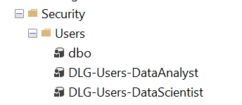

I have three azure active directory groups I need to grant access to our Azure AQL DB. Using the following query I managed to grant access to two out of the three:
CREATE USER [DLG-users-DataAnalyst] FROM  EXTERNAL PROVIDER
GO
And these groups can be seen here:

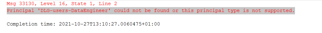

But when I try to my DLG-users-DataEngineer group I get the following error:
I know users has a lower case u, but surely this shouldn't stop the adding of a user group

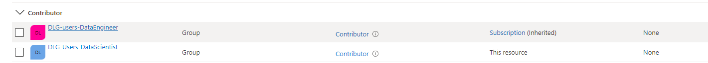

![144128-image.png]3
I have tried adding the group to the subscription as contributor and individually to the database. Always the same error

  1. James Hamil 27,221 Reputation points Microsoft Employee Moderator
    2021-10-30T00:04:07.03+00:00
    Hi @SB84 , you may need to change your query. From this article: https://community.dynamics.com/crm/b/crmchap/posts/principal-could-not-be-found-or-this-principal-type-is-not-supported-error-azure-sql-server
    you may have to add the tenant name for example:
    CREATE USER [john.smith_domain.co.uk#EXT#@test.onmicrosoft.com] FROM EXTERNAL PROVIDER
    Please let me know if this works or if you have any questions.
