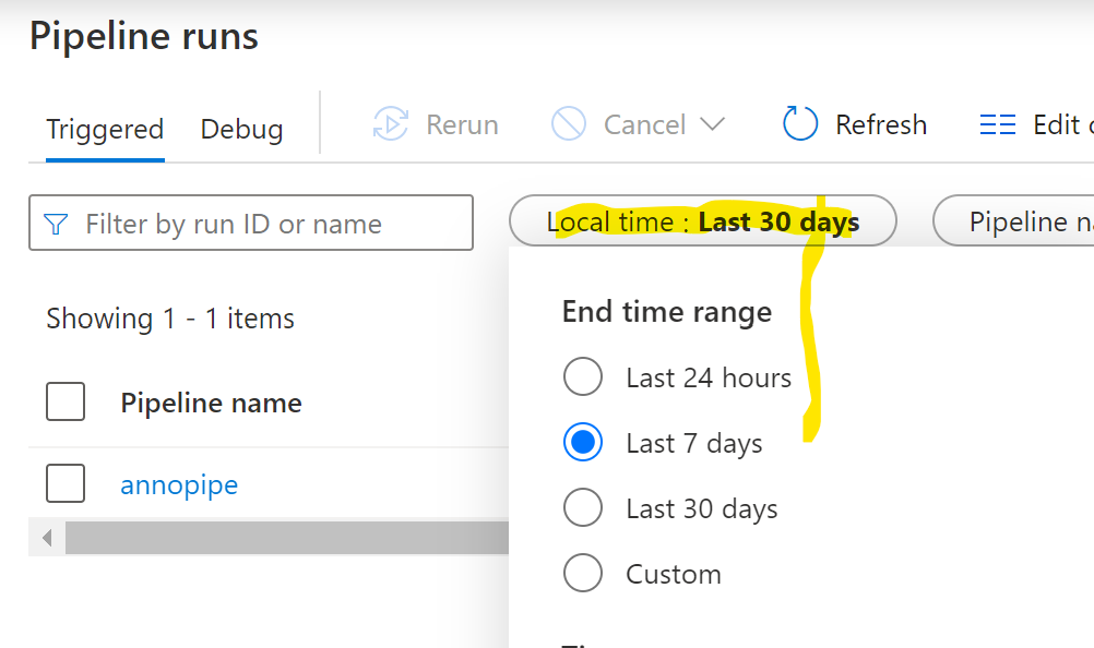

Hello Team,
I have scheduled the pipeline:
But not able to see that particular pipeline in the "Pipeline runs"
Please advise.
Regards
Rohit

    Hello @Rohit Kulkarni ,
    Thanks for the ask and using Microsoft Q&A platform .
    As you mentioned that you have "scheduled" the pipeline and I am assuming thats through a trigger , so it should show up in "triggers runs" .

    @Rohit Kulkarni there are some other things to note.
    The state of a trigger is not the state of the pipeline.
    When a trigger has started, it means "when the time comes to run the pipeine, I will run the pipeline" whereas a stopped trigger means "when the time comes to run the pipeline, I will not start the pipeine". In other words, it is an on/off switch for following the schedule.
    Since the trigger state is not the same as pipeline run state, the schedule might not have run it yet.
    I also noticed your filter has "In the last 24 hours". If your schedule is not daily, then perhaps it happened further in the past. Try expending the time range.
