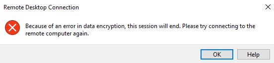

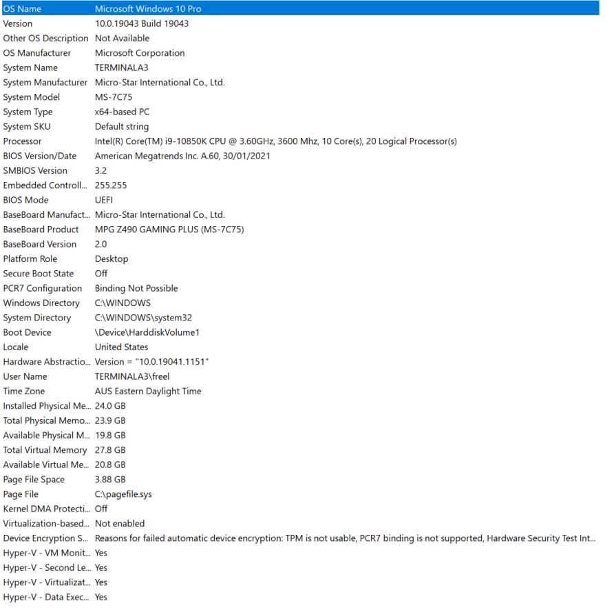

I have a LAN with 4 computers all using Windows 10 that I use for 3D rendering. I use one to remote into the other three. This was all working fine, however, for one of the remote computers (details), I had to recently use the "Reset This PC" function. After doing so I have been faced with various error messages whenever I try to remote in, which result in me being kicked out after 1 to 60 seconds. These include:
I should note all the other computers in the LAN can still be remotely connected to without issue and I'm not using a VPN.
Strangely these errors all but go away when the computer is actively rendering an animation (which uses high amounts of RAM, GPU, VRAM and network traffic). It could be rendering for days and the moment it stops I will get one of the above errors and be booted out.

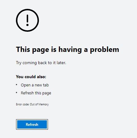

When using the device directly it will frequently drop out of web pages and give an error code: Out of Memory (regardless of browser). The device itself has 24gb of ram and is nowhere near capacity when those errors occur. When doing prolonged things like transferring files across the network or playing an online game there are no stability issues.
