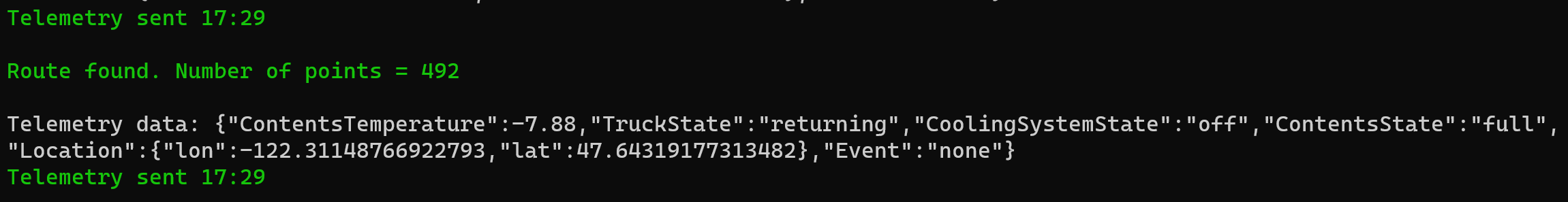

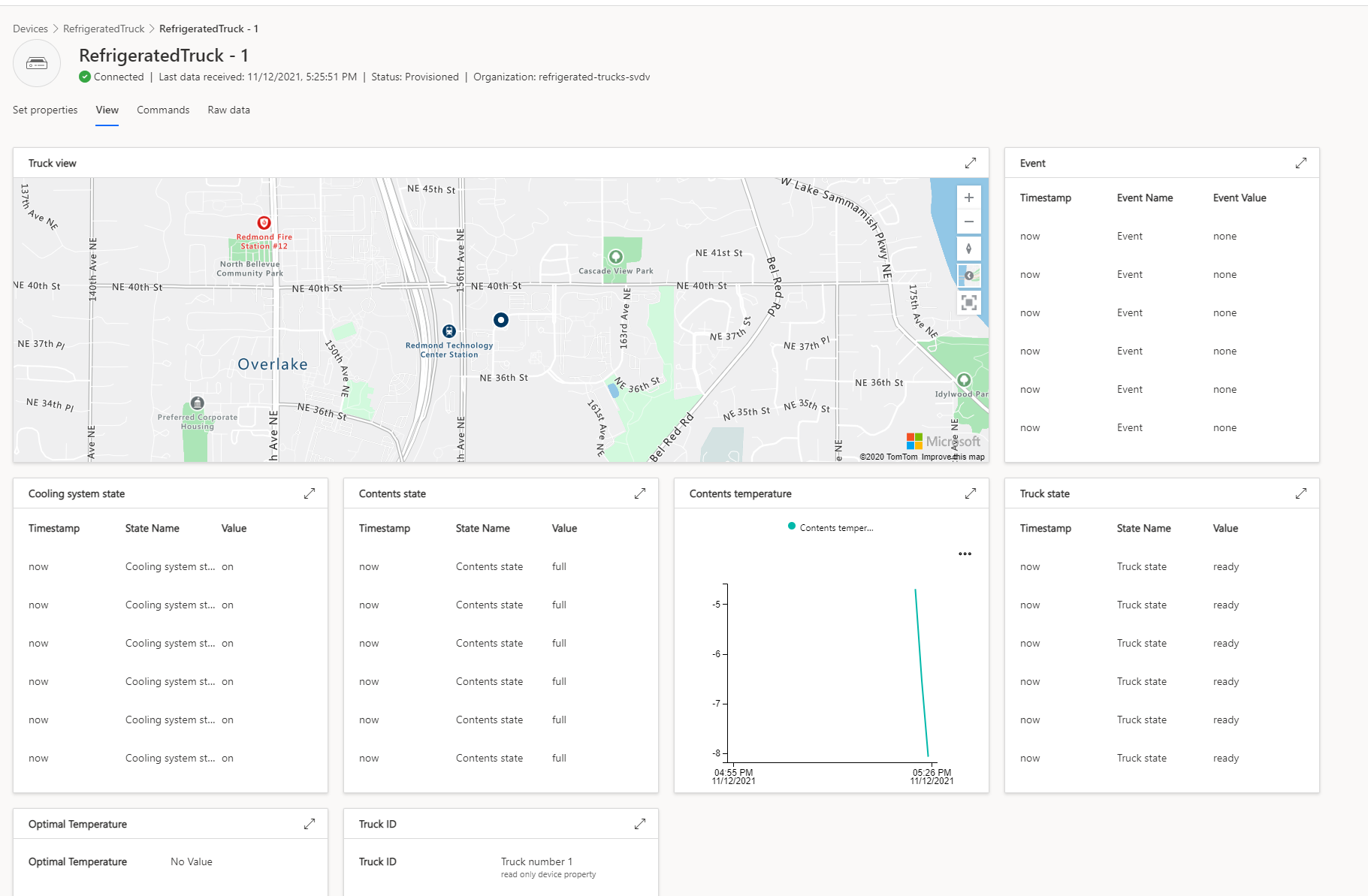

    I uses the VS Code-C# variant and I was a bit lazy so I copied the program.cs code from this GitHub location as advertised in the tutorial...
    My device is able to provision and I see incoming data:

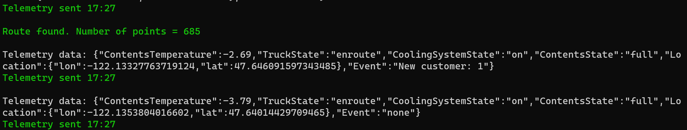

    I can input customer 1 and app is not crashing:
    Also, a recall works for me:
