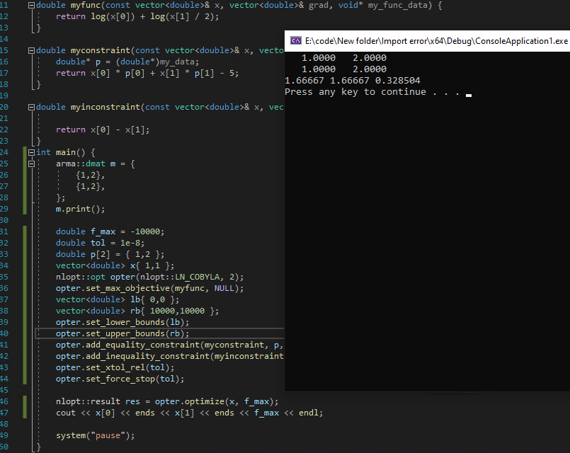

I made a minimum example, use x64 Debug to compile.
https://1drv.ms/u/s!AkqxTizATCPayWNinQzbqmlu2UIS?e=bl9bKx
Update2
I removed the c++ code and calls openblas/nlopt's C api directly. Note the changes sometimes needs "rebuild" to take effect.
https://1drv.ms/u/s!AkqxTizATCPayWT3LjElc5e7zltX?e=2rJgIB

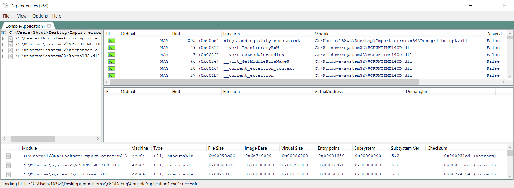

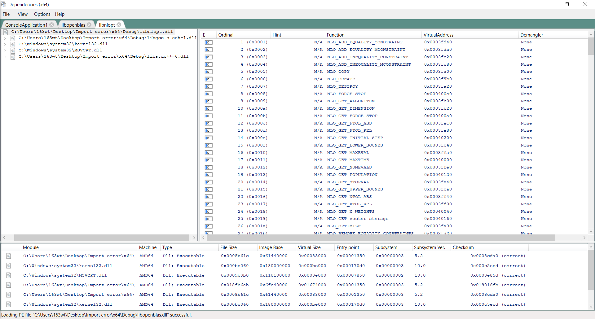

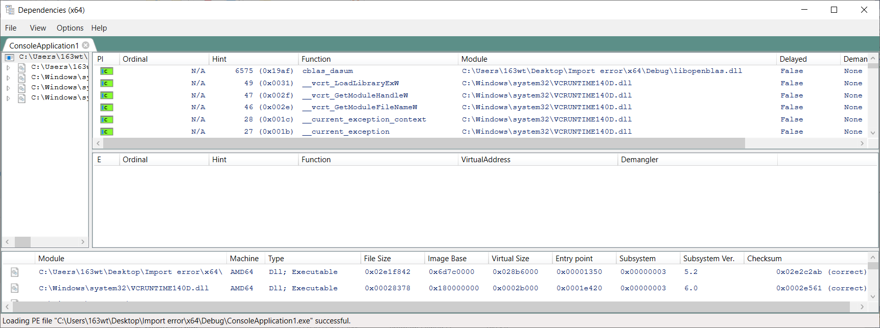

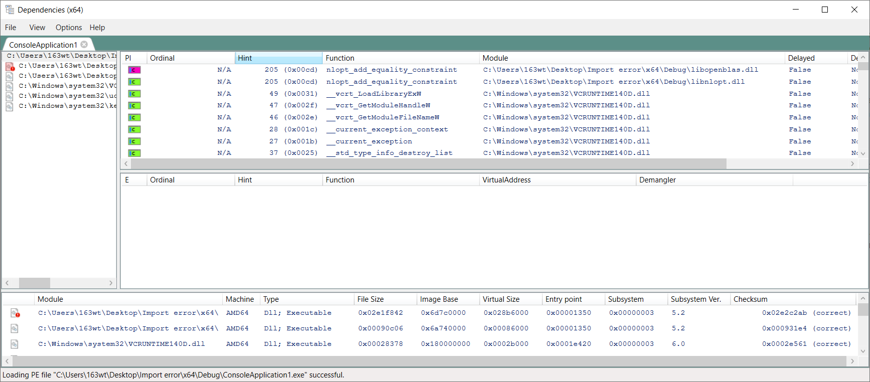

Also here's the import shown by Dependencies
only nlopt used, working
only openblas used, working, note the import name is correct.
both used, not working, the import of openblas is the same as nlopt (overwritten?).

    Since I can't see the code of the DLL, I tried not to use the namespace, and instead use codes such as nlopt::. Also, I modified the code m, and it can run.
