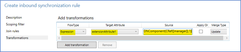

    This is a combination of the answers from Siva-kumar-selvaraj and DavidMoreno-4043. They get all the credit. I just wanted to put it in one screen since I don't always read all the comments and it took me a while to figure this out.

    1. Click Add Transformation, select the FlowType as Expression, and select extensionattribute(1-15) as the Target Attribute. In the Source text box, enter DNComponent(CRef([manager]),1). Click Add to save the rule.

  2. DavidMoreno-4043 35 Reputation points
    2023-02-08T13:14:33.4733333+00:00
    Hi guys,
    You can do it using the Dncomponent function from VBA
    https://learn.microsoft.com/en-us/azure/active-directory/cloud-sync/reference-expressions#dncomponent
    But first you should change the flowType to "expression" and in the source column put as below:
    Manager in this case, or whatever you want. The number specifies what value you want from left.
