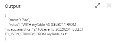

    You could use the expression formatDateTime(utcnow(),'yyyyMMdd') .
    It gives the date in the below format :
    You can use the above expression in the concat function.
    @concat('WITH myTable AS ( SELECT * FROM myapp.analytics_124168.events_',formatDateTime(utcnow(),'yyyyMMdd'),')SELECT TO_JSON_STRING(t) FROM myTable as t')

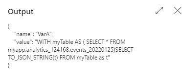

    From your comment I understand - I understand that you'd want a days old data. If that's your requirement - you could use the below expression.
    @formatDateTime(adddays(utcnow(),-1),'yyyyMMdd')
