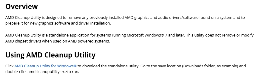

    At the driver level, you could try performing a clean install of the graphics driver and then try a relatively early version of the graphics driver.
    • The content in this link mentioned a tool to clean up AMD drivers. AMD Cleanup Utility
    • For AMD devices, you can access the product's driver page and check "Previous Drivers" to retrieve other versions of drivers. AMD Radeon™ RX 6600 Drivers

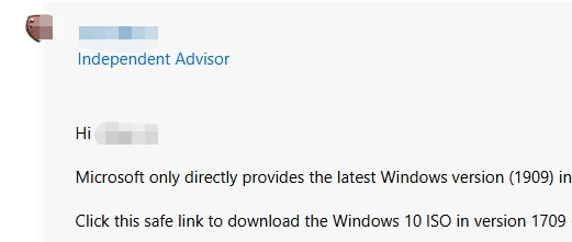

    At the system level, if it's convenient for you, you may want to try to obtain a Windows 10 system image file with a build date earlier than the one you're experiencing problems with and then perform a clean install of Windows.
    This option is often used to further verify that the problem is specific to a combination of hardware and software environments.
    • Discussion messages from community members in this thread mentioned channel to obtain some of the specific versions of Windows. The channel is not provided directly by Microsoft and you can refer to the information from Volunteer Moderator or Independent Advisor. Some of the links may be invalid and you may experience multiple redirects.
      Disclaimer: Microsoft provides no assurances and/or warranties, implied or otherwise, and is not responsible for the information you receive from the third-party linked sites or any support related to technology.
      Download windows 10 version 1709 - Microsoft Community
