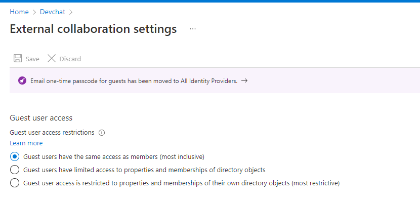

    3. Important: This error may also be caused if you are using a guest account, because guest users cannot enumerate all users by default, you need to set the same access permissions as members for guest users, or grant user administrators for your guest users. Log in to the Azure portal as a global administrator, and then go to: User settings>Manage external collaboration settings>Guest user access:
