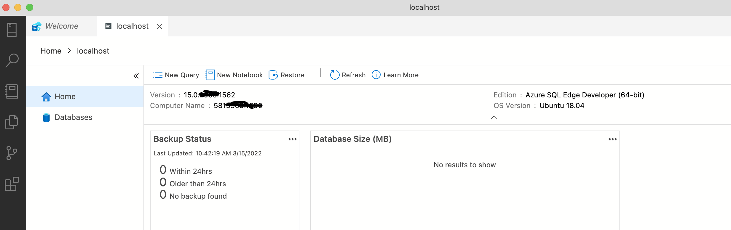

I am trying to connect to the SQL Server using Azure Data Studio, however unable to connect.
Connection Type: Microsoft SQL Server
Server: localhost
Authentication Type: SQL Login
User name: sa
ERROR:
Microsoft.Data.SqlClient.SqlException (0x80131904): A connection was successfully established with the server, but then an error occurred during the pre-login handshake. (provider: TCP Provider, error: 0 - Undefined error: 0)

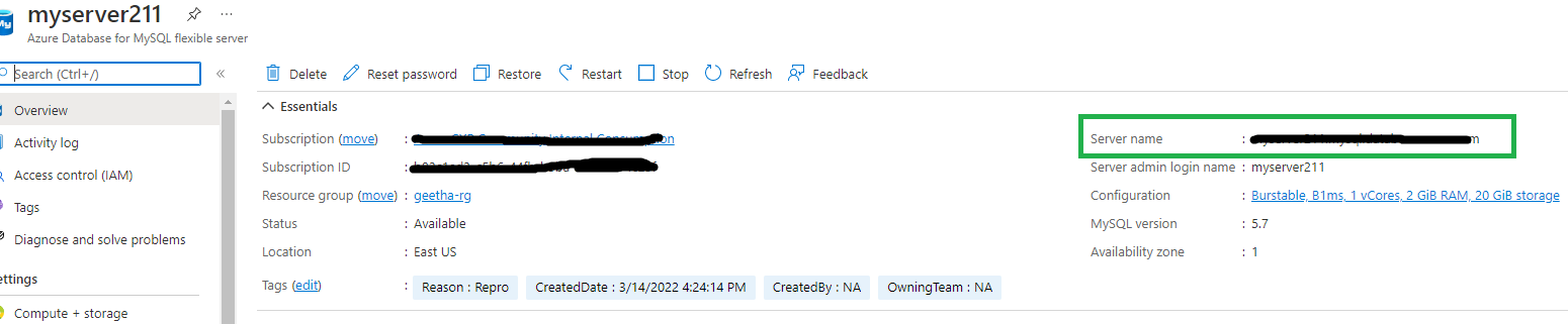

    Hi @GeethaThatipatri-MSFT
    how did you get this docker hostname? Thank you

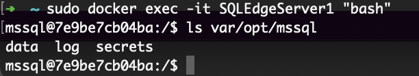

    As you've mentioned the problem here me to understand the server name that SQL Server instance sits in the Docker. I cannot connect to it using "localhost" or "127.0.0.1"
    however, I can connect to the SQL instance in the Docker using the Sudo command. ( I had to change the server name to "SQLEdgeServer1" due to security reasons as I left the password here in my earlier replies)
    sudo docker exec -it SQLEdgeServer1 "bash"
    I can connect to the server using sudo docker exe, however, I can't create a DB, there are no compatible mssql-tools for Mac.
