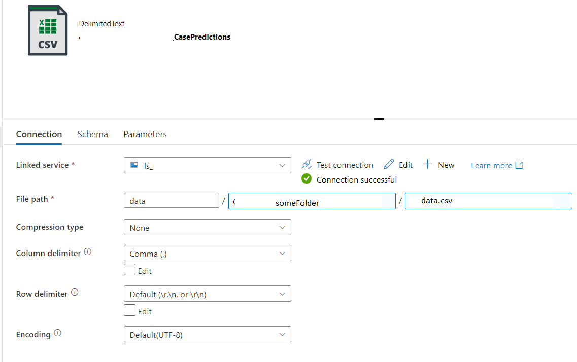

I have a dataflow that reads data from a source (Azure dataset), here is the source config:
I have the desired output before the sink. The sink configuration as as follows:
The problem is when I try to preview the data, it gives error:
I have no tableName variable anywhere is the pipeline. I am just trying to take data from a dataset, process it, and store the results in other datastet.

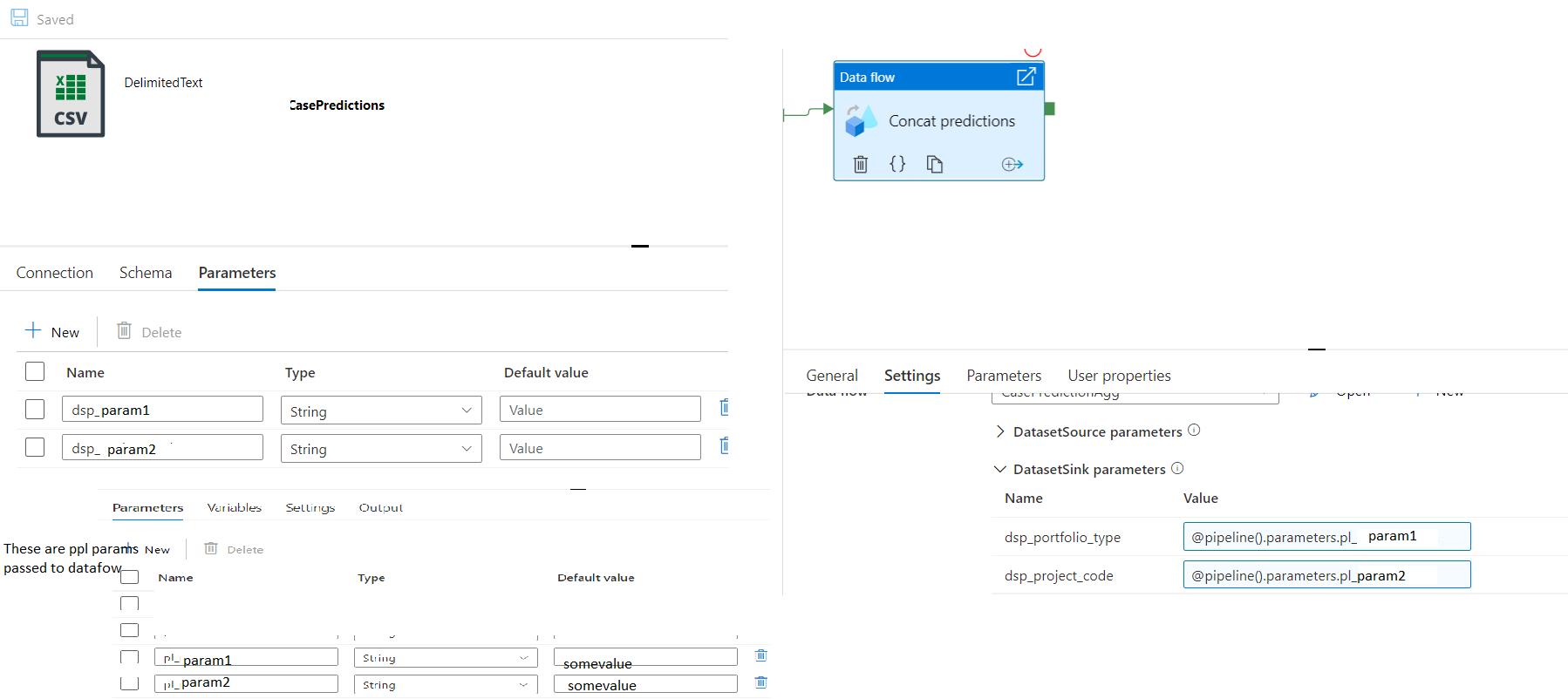

Also,
whenever I try to do the data preview for sink in dataflow, a new set of parameters are generated (named DatasetSink linked Service parameter for dataflow:
