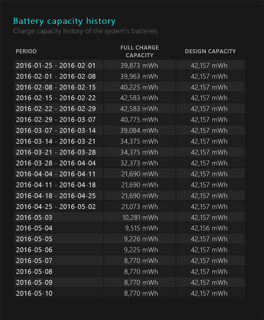

I've been using Microsoft Surface Pro 3 for a year, and shortly after the warranty expired I noticed my Surface Pro 3 can only last about 1-2 hours after a full charge. At first I thought this was a problem with background process draining the battery so I disabled everything running in the background. It didn't helped. Then I found out about the powercfg utility and run powercfg /batteryreport on it, and this was the result:
A full charge capacity has degraded by over 80% in just few weeks and continue degrading. I tried to "recalibrate" the battery by doing full charge then full drain multiple times, and it didn't helped. Talk with Microsoft via chat support and they insist this was a software problem and reinstalled the driver and asked me to wait few days to see if things improve. Not only it didn't improved, but now my Surface can only last 30 minutes.

    I've tried the steps in the link even before I chatted with support (and still do after) and it didn't helped at all. When it's plugged it shown "Plugged in, not charging (98%)" so I've tried solution 1 may be 4-5 times, solution 2 twice, I've lost count how many times I tried solution 3, solution 4 for about few days, solution 5 on every occasion I could do it. Nothing helped. That's why I eventually decided to call the local support via phone to see if they have any options. They didn't. So I fallback to posting here.
    As of today, powercfg reports capacity of 7,760 mWh at 100% charge. I really hope paying $560 isn't the only option I have.
