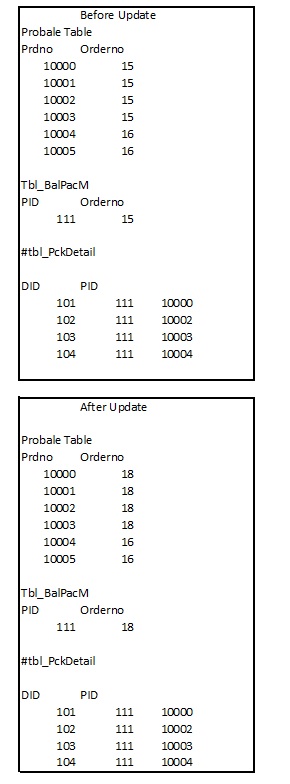

I want to Update table #tbl_BalPacM column Orderno From 15 to 18 by using trigger.
When Trigger is fired ,then it Check table #tbl_BalPacM column PID into #tbl_PckDetail column PID and all prdno which is exist in table #tbl_PckDetail
also exist in #Probale table ,then their Orderno will get change from 15 to 18

  1. Naomi Nosonovsky 8,881 Reputation points
    2022-03-25T15:18:39.417+00:00
    Try this trigger (I could not test as I cannot create triggers on the temporary objects):
    CREATE OR ALTER TRIGGER tr_tbl_BalPacM_upd ON #tbl_BalPacM AFTER UPDATE AS
       BEGIN
           SET NOCOUNT ON;
        ;WITH cte AS (SELECT i.orderno, det.prdno
        FROM Inserted i INNER JOIN #tbl_PckDetail det ON i.PID = det.PID)
        MERGE #Probale trg USING cte srce ON trg.prdno = srce.prdno
        WHEN MATCHED AND trg.orderno <> srce.Orderno THEN UPDATE SET
        trg.orderno = srce.Orderno;
       END
