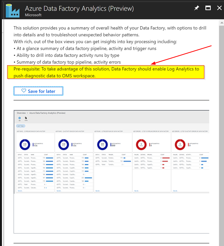

    Could you please confirm if you have followed this document to create the Azure Data Factory Analytics resource? - Install Azure Data Factory Analytics solution from Azure Marketplace

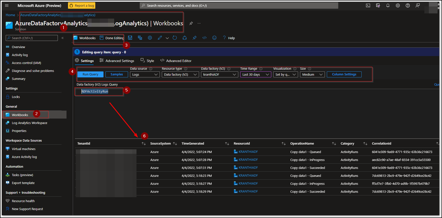

    To view the metrics, you will have to go to your Azure Data Factory Analtytics reosurces and under General tab go to Workbooks and then edit the query accordingly to view your particular resource metrics as shown below:
    Please note that Azure Data Factory Analytics (Preview) sends diagnostic logs to Resource-Specific destination tables. You can write queries against the following tables: ADFPipelineRun, ADFTriggerRun, and ADFActivityRun.
    In order to take the advantage of this feature, please follow the below pre-requisite as called out in the above documentation.
    Hope this will help. Please let us know if any further queries.
