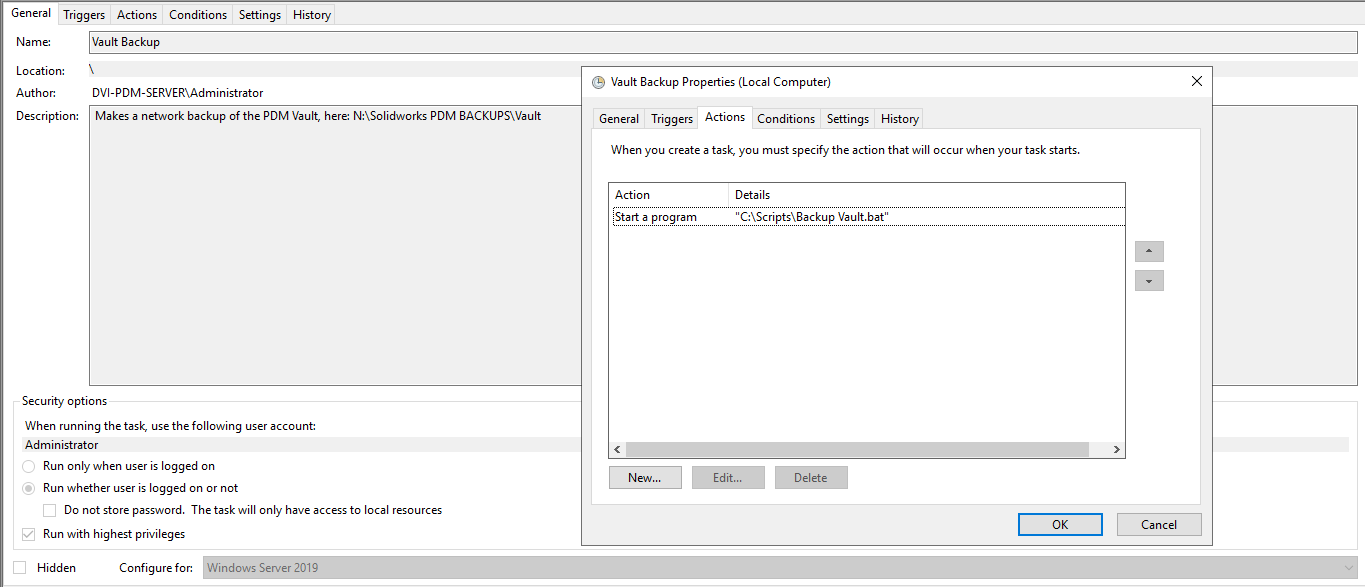

I install and configure Windows Server 2019(bare metal), then I install SolidWorks PDM and get it fully configured with its included SQL Express 19 installation and then lastly I configure the backups of the SolidWorks PDM/SQL components using some batch scripts and the Task Scheduler. (following this tutorial
https://www.goengineer.com/blog/solidworks-pdm-guide-to-pdm-standard-backups I have tried both Option 1 and Option 2 when it comes to Backup Method 3)

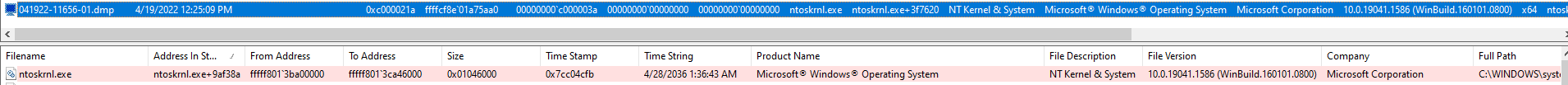

I also saw this in the tool BlueScreenView:

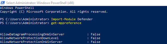

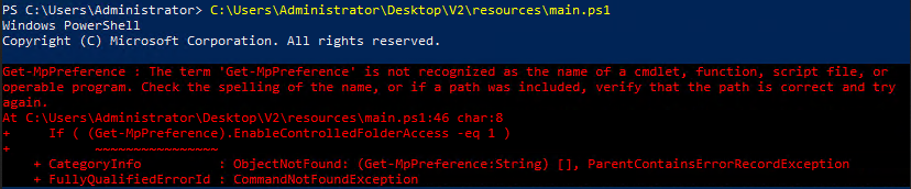

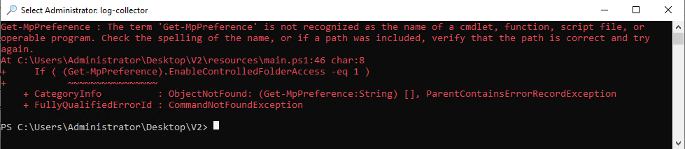

    I tried to run V2 but can't get past this error.
    I found that in Powershell(x86) I could run "Import-Module Defender" and then run "Get-MpPreference" and I'd get a response
    but when I ran the "log-collector" shortcut or even just try to run "main.ps1" I get these errors.
    Any suggestions?

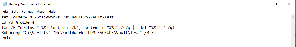

    In an effort to narrow down what could be the cause of this I decided to make another Hyper-V virtual machine with Windows Server 2019 and all I did was install the OS and all of the updates through Windows Update(no SQL or SolidWorks PDM). Then I set up the same Task Scheduler script I have been using this entire time.
    Its simple a batch script that deletes the contents of a network drive folder and then calls robocopy to copy a folder to that same location on a network drive. (On this Virtual Machine Test it's set to an arbitrary folder I created with some empty text files in it, as SolidWorks PDM isn't installed so the normal folder I'd backup doesn't exist.)
    This ran fine and I rebooted it 5 times while making sure to run the Task Scheduler event once between each reboot.

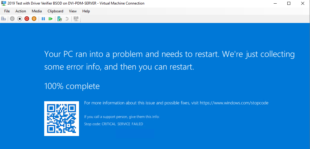

  5. Zach 1 Reputation point
    2022-05-11T15:57:36.417+00:00
    This server isn't live because it's brand new and currently isn't stable enough to push into production, so currently there is plenty of down-time to debug.
    I recreated the same installation as before and I enabled WDV following the tutorial @Docs linked. The only issue is that when WDV is enabled, the BSoD that follows the next restart is seemingly frozen on the BSoD(normally it finishes saying it can't repair it and then it loads into the Windows Recovery Environment):
    I read that WDV can make things run much slower, currently its been on the 100% BSOD screen for 20mins, I'll leave it for a while longer to see if it eventually changes.
