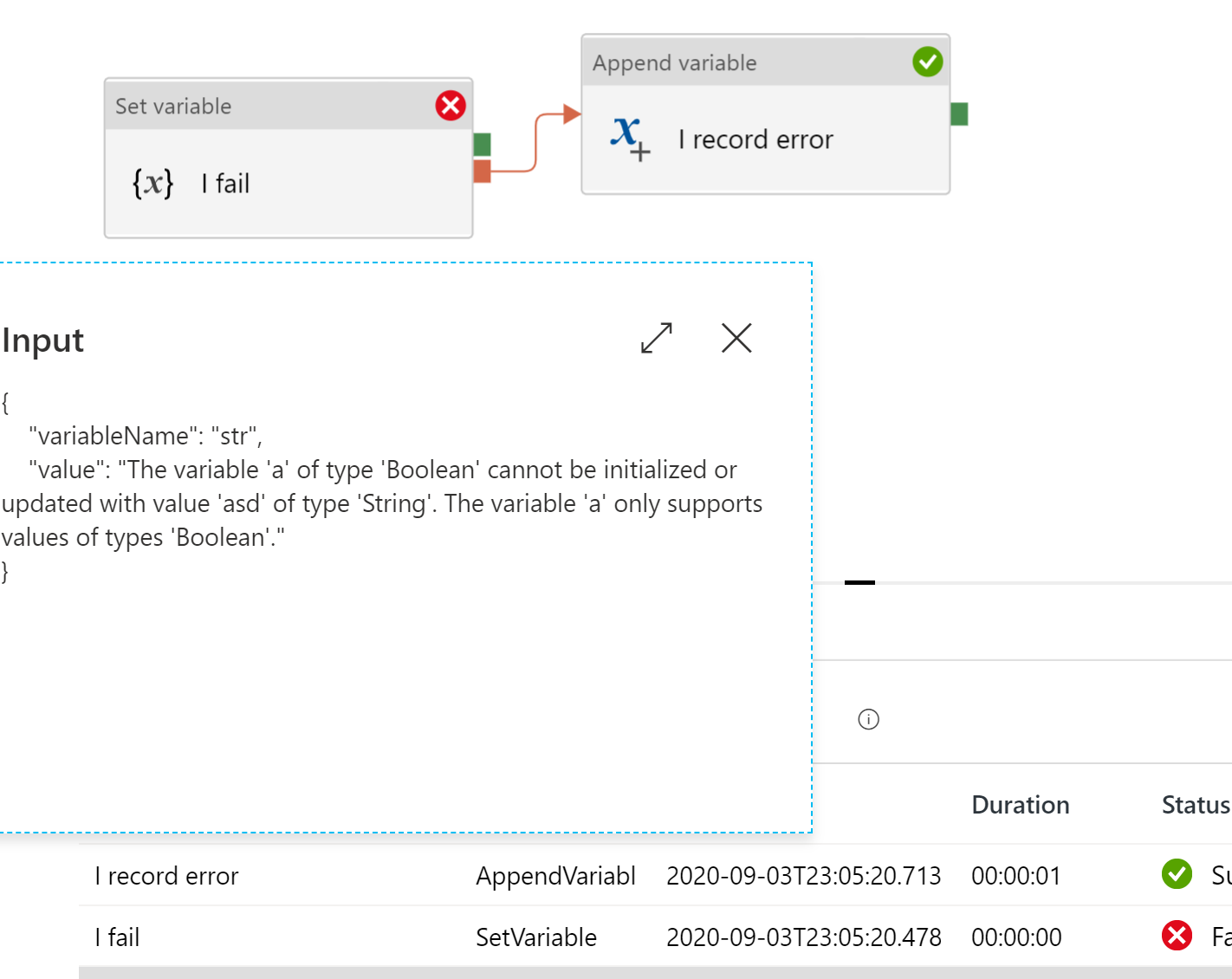

    1. Another options is to take advantage of the way success / failure is determined. It is possible to engineer an activity to fail. It is also possible to capture error messages for later use in the pipeline. On the inner loop activities (and wherever else you think it is likely to fail) connect an Append Variable activity via the failure dependency.
    If you have a loop, you should use an array type variable and the append variable activity, so if more than one activity fails, you can capture all of them.
    Then at the end of the pipeline, place a Set Variable activity. This one we will engineer to fail if our array contains any error messages, and succeed if it is empty. Because of the way we engineer to fail, the input (the array contents) will be displayed in the final error message. This final Set Variable activity should use a boolean or integer to cause a type error.
    It is important that the finall Set Variable activity, should it follow a container type activity, be connected by on-completion or on-success dependency. This is because with the way we captured the inner errors, the container activity may no longer report itself as failed. Please let me know if you would like to know the reasoning behind this.
    For the final Set Variable activity, I used the following expression:
    @if(empty(variables('errors')),true,variables('errors'))
