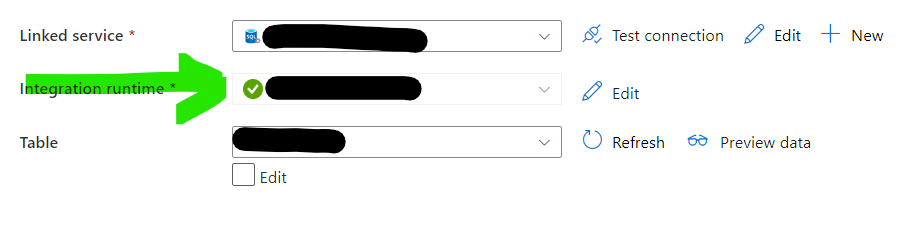

    This was a simple fix for me - I had not published my changes after changing the integration runtime on each of my linked services.

    In your source2 that needs the custom IR go to the activity, open it and you should see what runtime it is set to use. Once you have the correct runtime selected then save / publish and test.

    That is correctly configured and published too.

    At last we were able to resolve the issue. The problem was that we missed to change IR mapping inside the pipeline data flow. Because of that it was failing.
