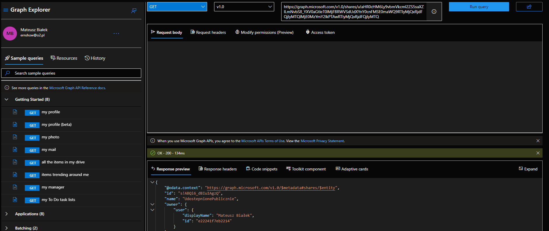

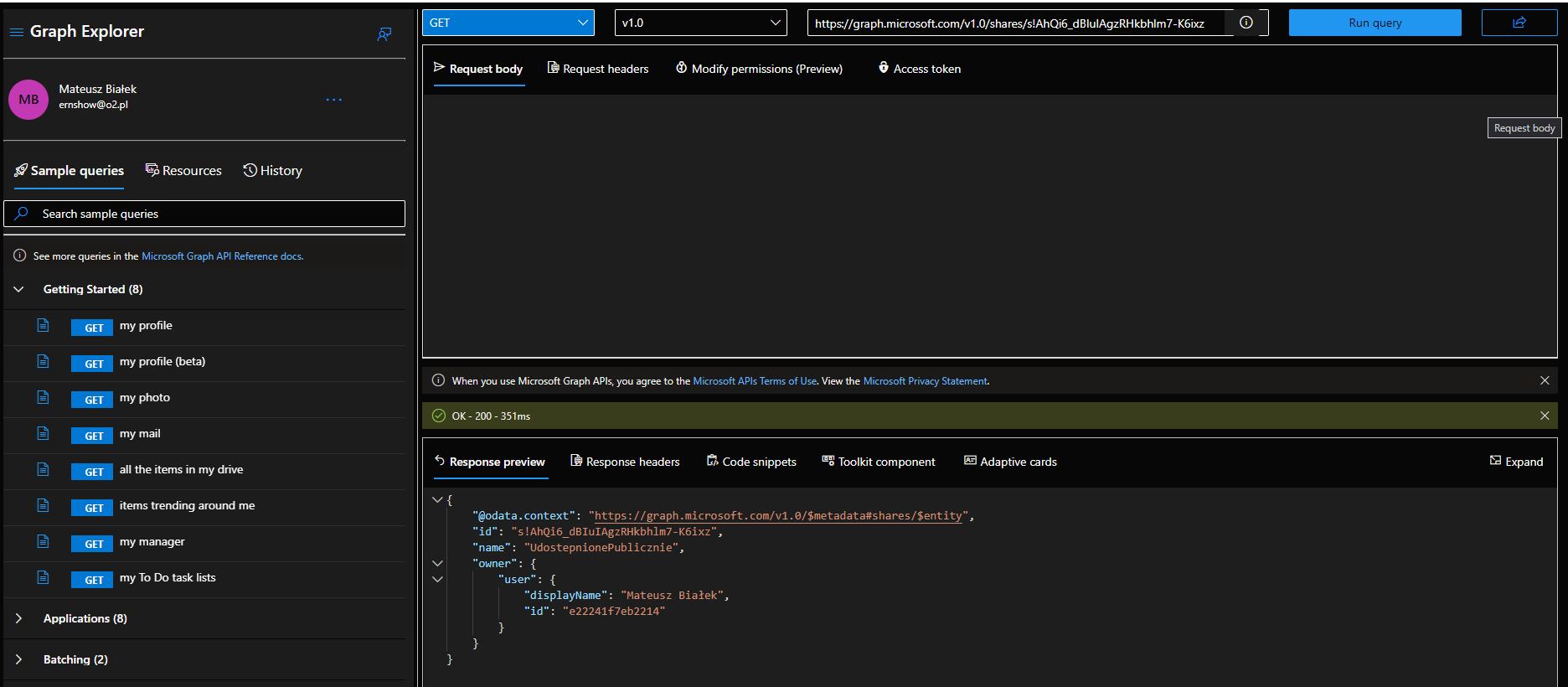

using credentials from the private account. It works, I get the ShareId value and also a WebUrl value.

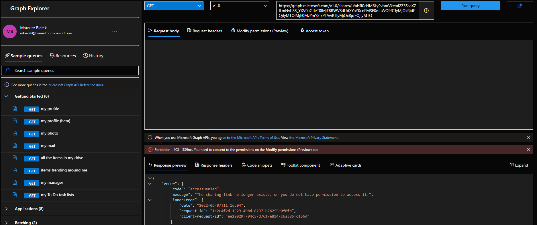

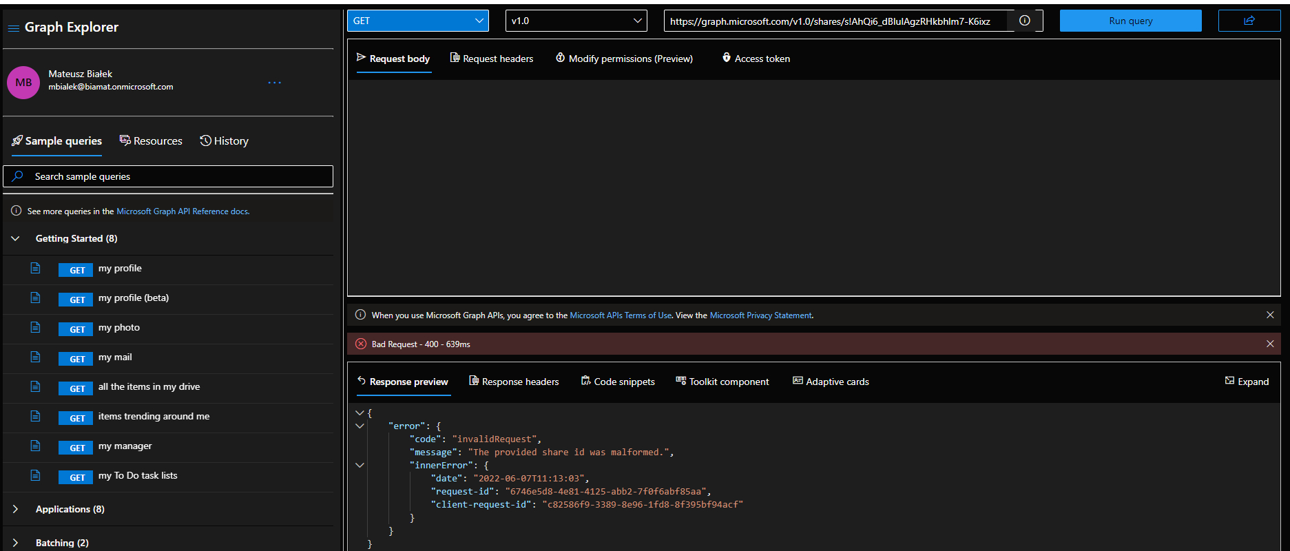

Using Graph Explorer, I can access the folder using (GET) https://graph.microsoft.com/v1.0/shares/<ShareID> or https://graph.microsoft.com/v1.0/shares/<encodedWebURL> but ONLY when signed in with my private account. I get proper id, @odata.context etc.
When using developer account the result is the same as above - "The sharing link no longer exists, or you do not have permission to access it."
