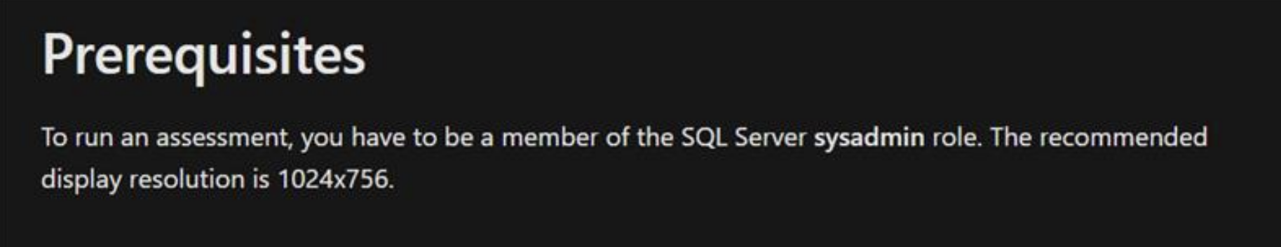

    Errors suggest the SQL login that you are using does not have permissions to run the TSQL
    does the login have a sysadmin role assigned?
    You can check this document on how to assign and give it a try.
