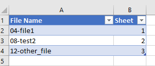

I am trying to do it so that based on a table (with the name "sheet_select_table1"), it does a lookup of the name, and if it matches column A, then only use the sheet on column B and convert such specific sheet number into PDF.
For example:
If there is a file with the name "04-file1.xls" it would go through the given path and only turn into PDF sheet 1. Similarly, if there is a file "08-test2.xlsx" it would only turn into PDF sheet 2.
Also, just to clarify, the macro_file.xslm will be the one running to convert other excel files (in the given folder) into PDFs. There will be no content in the macro file other than the table indicated above, so there is no need to convert it into PDF.
If the files do not match the name, import all the sheets (which is what it is currently doing).
I think it would have to have an IF function to go over the table.

    See https://1drv.ms/x/s!Avg5eRPJ5YjoiD6qLCuY5jLqtAJ1?e=4jYJf2
    Note:
    This can go within the If Err > 0 check:
    Set mybook = Workbooks.Open(MyPath & MyFiles(Fnum)) ' copied
    this will avoid opening the file when it is not to be processed
4 additional answers
    2022-06-02T18:10:25+00:00
    Awesome, it worked! Thank you for all your help.
    Plus attaching the excel link/example.
    I changed it within, and now it is more efficient! Thank you for the tip.
    I also added ", UpdateLinks:=False" to:
    Set mybook = Workbooks.Open(MyPath & MyFiles(Fnum), UpdateLinks:=False) ' copied
    Since some of the files that had links were causing some prompts and issues.

    Also, I did name the sheet of the macro file "Lookup." where the table of columns A and B are located.
