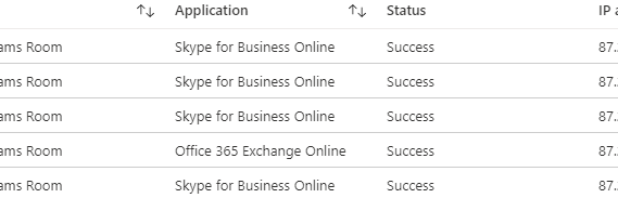

In Azure AD for the account that is not working I see successful sign in for Office 365 and for Skype for Business.

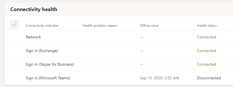

    2020-09-15T02:41:20+00:00
    Hello Phil McShee,
    Since both account were synced from your local AD to Microsoft 365 cloud, first please make sure the problematic account was successfully enabled/linked to the Microsoft 365 room mailbox, first please temporarily remove the Teams room standard licence, Skype for Business online license and other licenses if available from this account in Microsoft 365, then please wait for half an hour.  Then please connect to Exchange Online Powershell to re-run the command  ***Set-Mailbox -Identity 'your account' -EnableRoomMailboxAccount $true -RoomMailboxPassword (ConvertTo-SecureString -String <password> -AsPlainText -Force)***For more details, please refer to https://docs.microsoft.com/en-us/MicrosoftTeams/rooms/with-exchange-online.    After that please re-assign the teams room and other associated licenses to this account to see if it make any difference, thanks.
    Moreover, since the account can sign in Skype for Business and Microsoft 365, please double check if you could sign in Microsoft Teams via https://teams.microsoft.com/ at your convenience, thanks.  By the way, please also check if there is any conditional access policy associated with this account in AAD which may block the account to sign in Teams room, thanks.
    On another hand, if the issue persists, I'd like to collect some more information for further troubleshooting
    1. If you only assigned Teams room, Skype for Business online Plan 2 or higher licenses?  Do you assign Microsoft Teams licence?
    2. Please take a full screenshot about the error message when you used this account to sign in Teams room.
    3.  Based on your description, it is more likely you got some error from the Azure AD user sign in activity when you used this account to sign in Teams Room, please also provide the errors you got from AAD to me here, thanks.

  5. Anonymous
    2020-09-15T08:57:12+00:00
    Hello there
    I have exactly the same problem with our Logitech TAP Rooms System with the same error massage "Cannot sign in into teams". The environment is similar, Exchange 2019 / Microsoft 365 Hybrid (all mailboxes in Exchange online and the Teams Rooms account was completely created in the cloud only.
    • SIP = SMTP = UPN is correct
    • Assigned "Conference Room" SKU only
    • Time and time zone is correct on the Microsoft Teams Rooms device
    • I can sign in by web browser to teams on the Microsoft Teams Rooms device without any problems - conditional access rules disabled for this user.
    • Same in AAD, the sign in for Office 365 and Skype for business is shown as "successful". No errors, but looks like it's not even trying to connect to Teams.
    • No SfB on-premise
    I tried the advice from Oliver Wu but that didn't make any difference. So we have bought that room system over one month again and it's still not working and no solution yet even by Microsoft 365 support.
    Maybe we get any solutions here, I really hope so.
