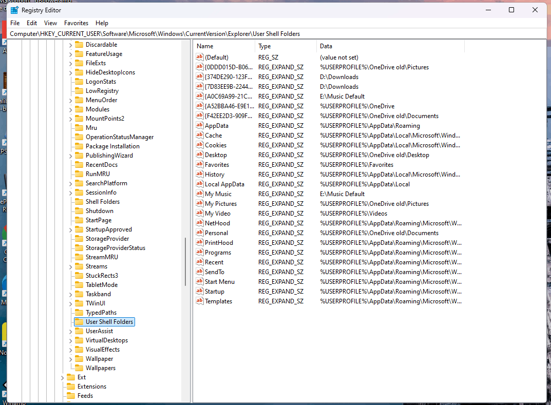

    Ok, moving on to address the shell folder location issue. Please type regedit in the search on the taskbar to launch registry editor, and go to this path, then take a screenshot and share in your reply.
    Computer\HKEY_CURRENT_USER\Software\Microsoft\Windows\CurrentVersion\Explorer\User Shell Folders

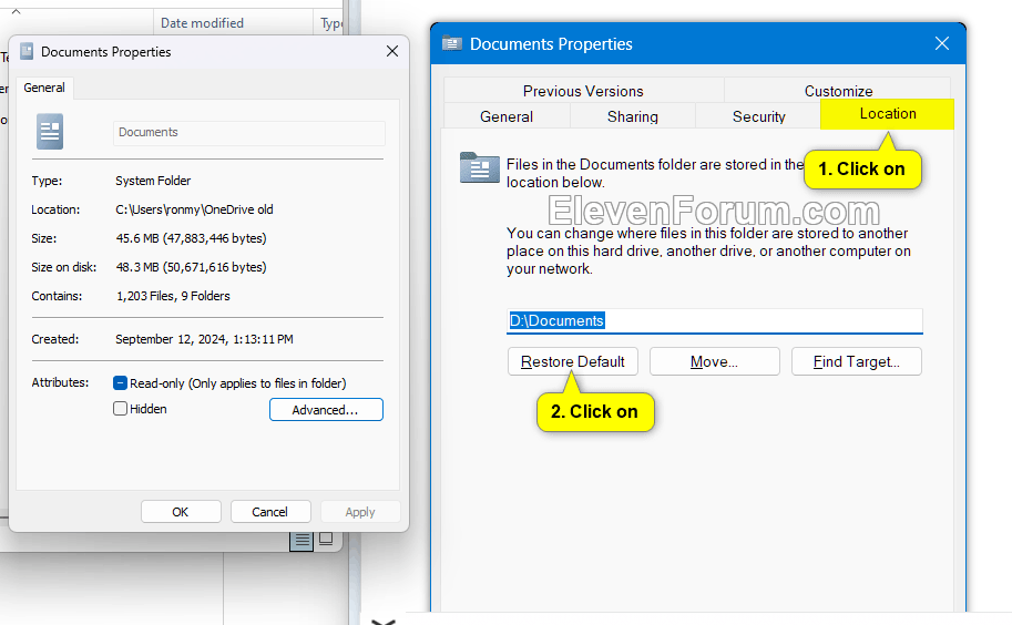

    2024-09-16T19:45:03+00:00
    I tried Shawn's suggestion, and it appears that the system thinks that my Documents folder is in a folder called One Drive Old. However, no options were presented in Properties for restoring defaults. Here is the Properties dialogue to the left, along with the example in the tutorial Shawn referenced. I await Emily's response to my reply.
  3. Brink 16,560 Reputation points Volunteer Moderator
    2024-09-12T18:03:49+00:00
    Hello,
    You can try moving your Documents folder location using option one in the tutorial below using "shell:Personal" to open the current Documents folder location.
    https://www.elevenforum.com/t/move-or-restore-default-location-of-documents-folder-in-windows-11.8708/
    If that doesn't help, then use option three above to restore the default location, then try moving the folder again.
  4. Brink 16,560 Reputation points Volunteer Moderator
    2024-09-16T20:04:31+00:00
    If you like, option 3 below should restore the Documents folder back to its default location.

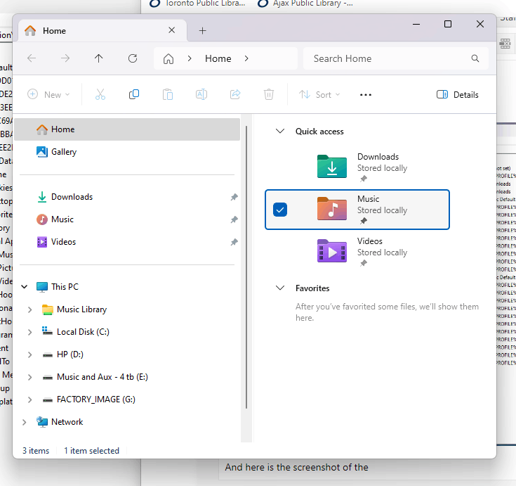

  5. Anonymous
    2024-09-15T19:52:04+00:00
    Thanks.
    Here is the Registry screenshot:
    And here is the screenshot of the quick access part of the Explorer window. Note that no Documents folder is in there.
