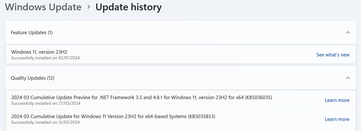

KB5035942 and KB5036035 were both available as updates on my Windows 11 PCs. I installed them on two devices successfully, but on one device KB5036035 got stuck at downloading 98% for hours. KB5035942 installed fine.
As the second KB got stuck, I restarted the device and it said 'installing updates' and then I noticed KB5036035 was available again and downloaded and installed fine with a further restart.
The problem is, I cannot find KB5035942 listed in Windows Update history as installed today like on all my other PCs or available to uninstall.
I can see though that it has I think been installed through reliability history.
How do I know if this KB has been installed correctly and do I need to be concerned that it's not showing in Windows Update history or available to uninstall?
Thanks!

    Thank you for your feedback. According to Microsoft's official support notes, if you successfully install this update, your computer version will be updated to 22631.3374.
    You can check your PC version by the following method. Press win+r and type:
    winver
    if the version is 3374 after that means you have successfully installed the update, just because the display bug can not be displayed, does not affect your use.
    March 26, 2024—KB5035942 (OS Builds 22621.3374 and 22631.3374) Preview - Microsoft Support
    If it did not install successfully, you can try to install the update manually by following the link below.
    Microsoft Update Catalog
    Enter the number of the update, and then select the model number of your computer.
    Please let me know if you have any other questions or if I haven't explained something clearly.
