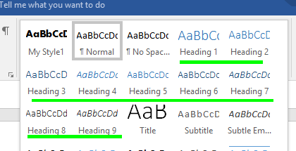

    In Word , only the built-in headings will appear in the Cross-reference heading list..

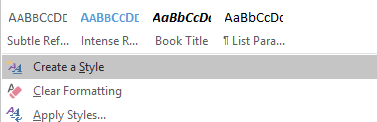

    I assume you created some customized heading styles via clicking the arrow in the Style section under Home tab > Create a style, if so, these headings will not appear in Cross-reference heading list.

    I have been creating documents with headings using the process you mentioned above (i.e. clicking the arrow in the Style section under the Home tab, then clicking Create a style) for many years and it has always worked.

    Any numbered paragraph, including numbered custom headings, will be in the "Numbered item" category (under "Reference type") of the Cross-reference dialog box.
    The "Heading" category, though, only includes paragraphs formatted in Word's built-in heading styles.
