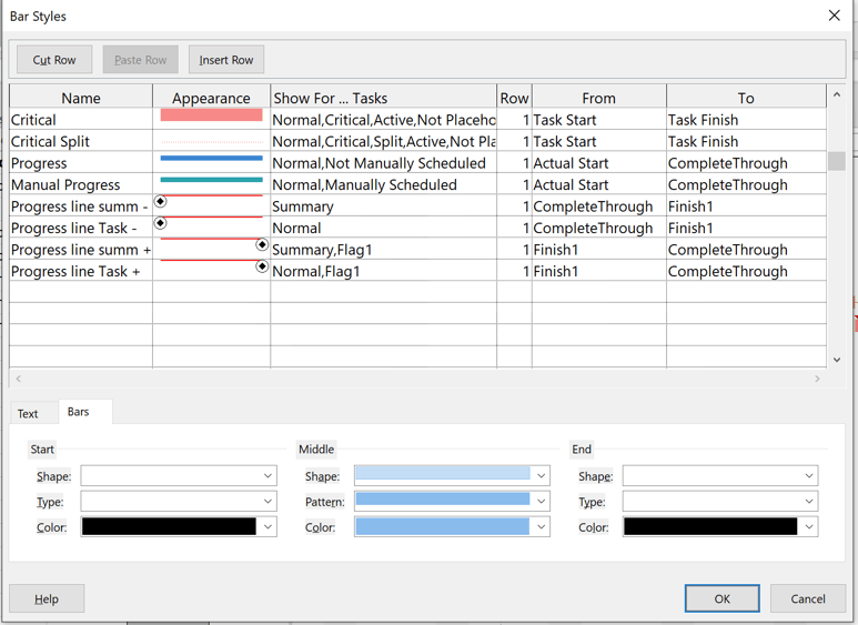

As a workaround try this approach.
  1. Create a custom Date field (e.g. Finish1) with the simple formula
Finish1=[Status Date]
  1. Create a custom Flag field (e.g. Flag1) with this formula
Flag1=IIf([% Complete]=0,"no","yes")
  1. Set the option to use that formula for "task and group summary rows"
  2. Create four new Bar Styles as shown (or similar)

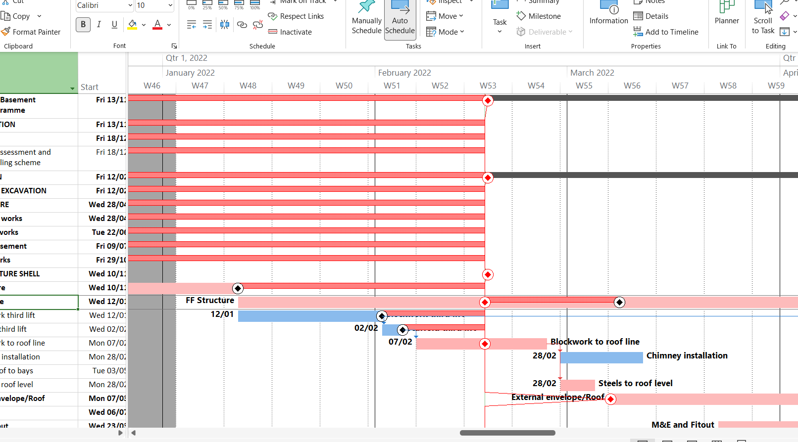

    Hi John
    Replying to this because i raised the progress lines as an issue elsewhere and was directed here.
    I have given this a go, and this is what i am getting. Is this correct or am i doing something wrong?
  3. John Project 49,695 Reputation points Volunteer Moderator
    2022-02-17T16:30:40+00:00
    Kyle Kilmartin,
    It looks like you've got it right but it's a little hard to tell since the tasks in the upper part are off to the left of the view. You also may want to turn off showing the critical path or perhaps change the color of the mock progress lines for easier visual reading.

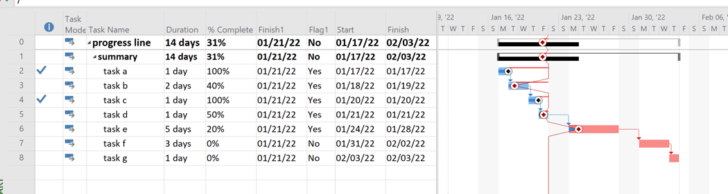

    For reference, this is the test file I created for developing and testing the workaround. Ordinarily I would not display the "real" progress lines along with the mock progress lines as it makes it harder to see the mock progress lines but it does provide a visual comparison. Note, the two summary line mock progress lines are quite hard to see due to the thin line style I chose.
    This is what it looks like in Print Preview, which of course is the reason for the workaround.

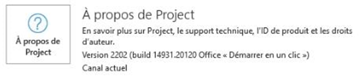

  5. Anonymous
    2022-03-02T05:41:12+00:00
    aaaaaaaaaand our prayers must have been heard somehow...yesterday we updated the software one more time, and there came another version that seems to have fixed everything!
    Progress line is here every time and stays where it is supposed to be on the printed documents.
    I hope that this version has also fixed all the problems everyone here is experiencing :)
